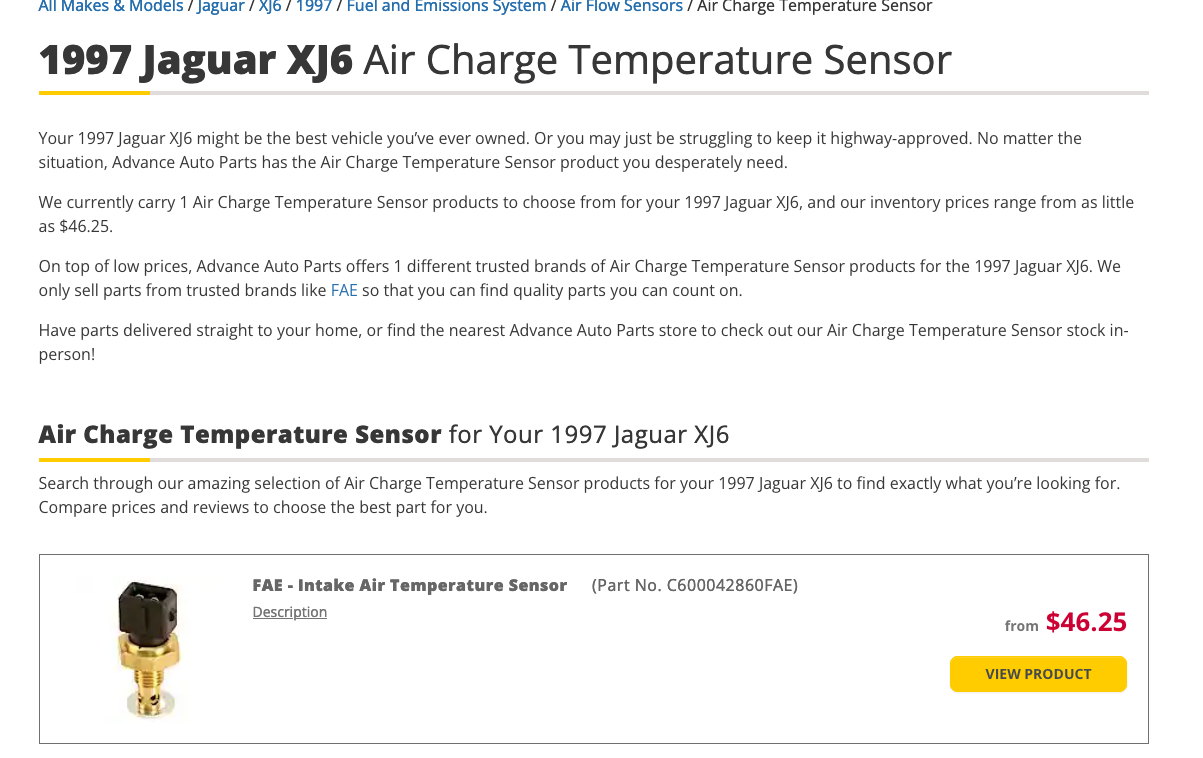

This is what I found but does not look like the original

Sorry, confusing title. I am looking for the sensor on the elbow where the MAS is

LHE1602AA which is a different part # that Bob ( Motorcarman ) came up with , but he would know more than !
And yes it is close to the MAF part #
Genuine Air Box-air Flow Meter-3.2/4.0 Litre (less 6.0 Litre) For Jaguar Xj 1995 - 1997 (from 720125 To 812255) (x300) Classic | Jaguar Land Rover Classic Parts

LHE1602AA
which i believe is the same as the XJ40/XJS EAC2863
the part number motorcarman listed was for the incorrect part.
it is for the ambient air temp sensor that sits in the LH brake duct
