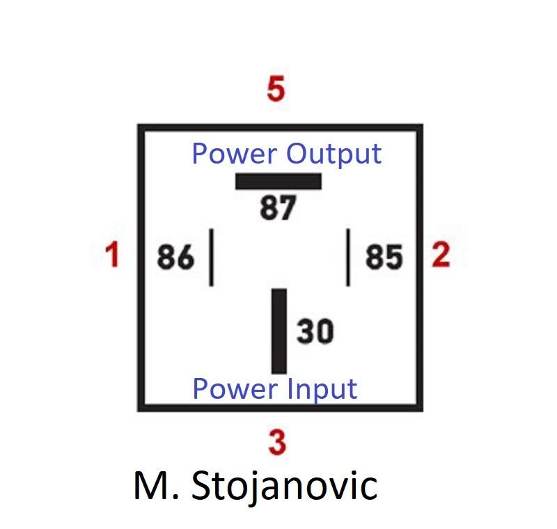

For a 97 XJ6 / X300
The auto parts stores will read codes for free
If no codes you can kumper the fuel pump relay and skip the relays control command
Nearly empty fuel tank causing freezing of the fuel filter ?
for the normally aspirated engine you only have the # 1
Editing
