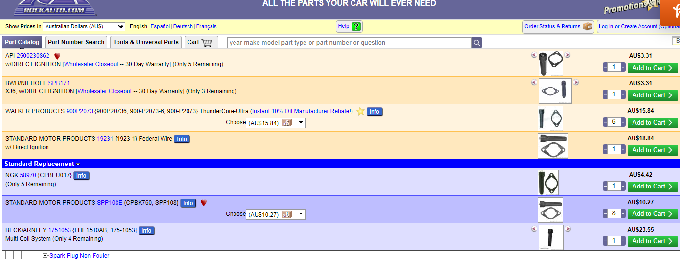

ok so another question.
I saw someone mention that you can buy just replacement boots.
now given that i don't think i have any misfire, i think the coils are all working fine, but what i do know for sure is the boots on atleast 4 of them are swollen and gone leading the coil to not fit tight and snug on the plug.
now when i look on rock auto i see all the cheap ones are not having 6 in stock.
so my question is simple and i am sure i know the answer but the only stupid question is the question you don't ask.
would there be much difference between the boots?
i assume no issue to use say 3 of one and 3 of another?
i assume the metal spring does not need to be used if mine is in better condition / better thickness.
also is it just as simple as pull off boot and put new boot on?

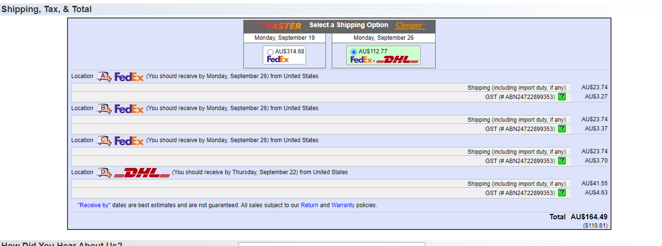

***edit...
scratch that idea. unless i can find somewhere with better postage options....
i have 8 coil boots (always like to have a spare)
and 2 top radiator mount rubbers.
and these are the only shipping options.
my goodness me.
why can't i just get it shipped usps in a satchel bag for i dunno like $20 bucks or something. jeepers!!!!!

In the long run you will be better off with Australian sourced parts.
At least we have federal consumer protection if the bits don't work It is called "not fit for purpose". And we do have a relatively simple system to get your money back
These overseas carriers are making a "motsa" of money. I have just about given up on all of the major carriers as well as the UK and USA postal systems

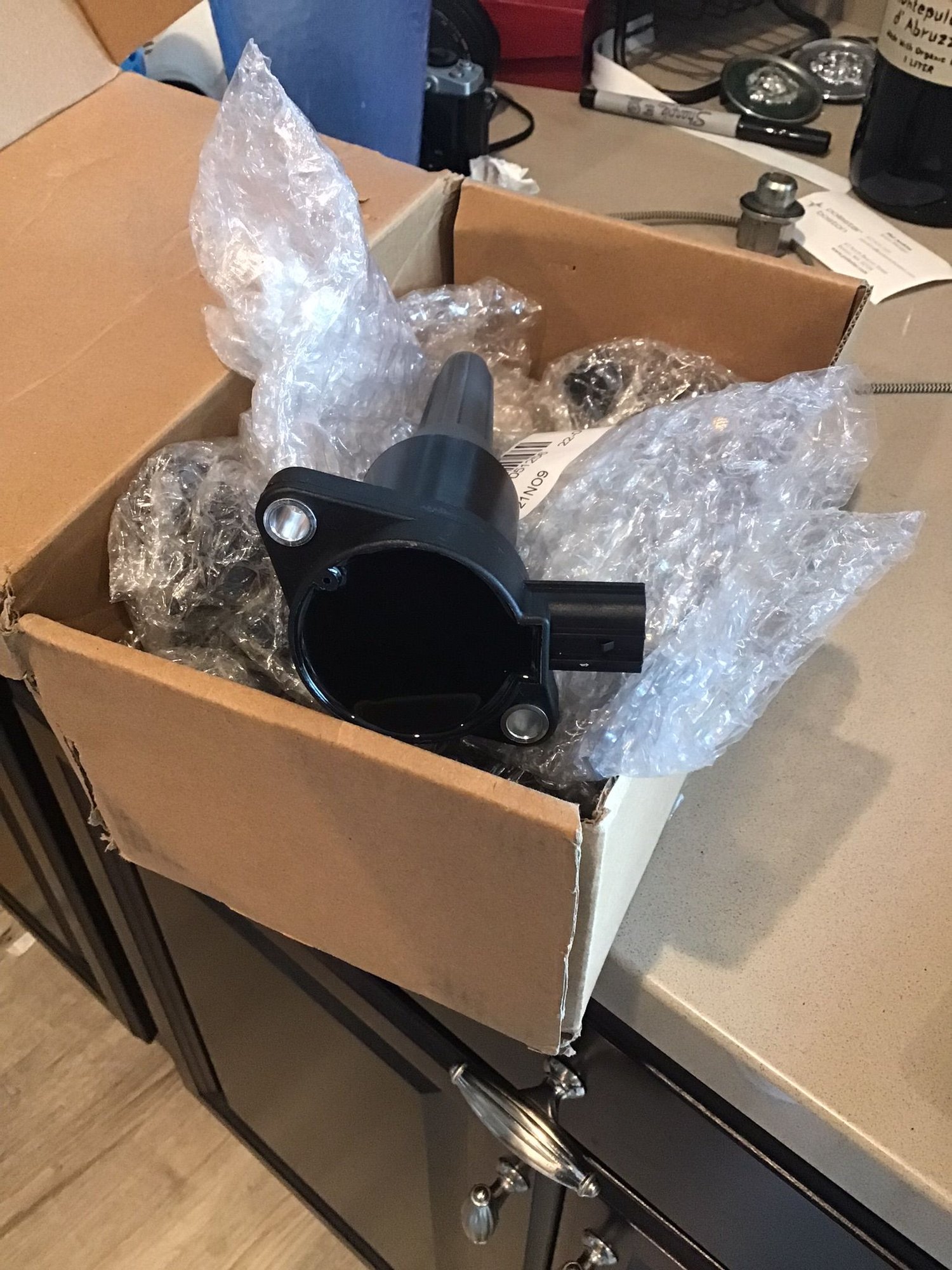

Just received these today. They're not the good ones; they have silver bolt holes, and the rubber on the bottom portion is suspiciously soft. I'm not even going to bother opening them up, and am returning them to Walmart.
However, it looks like coils that are branded with "Brock" may be the good ones. I have a set of those on the way and will report on them when they arrive.
