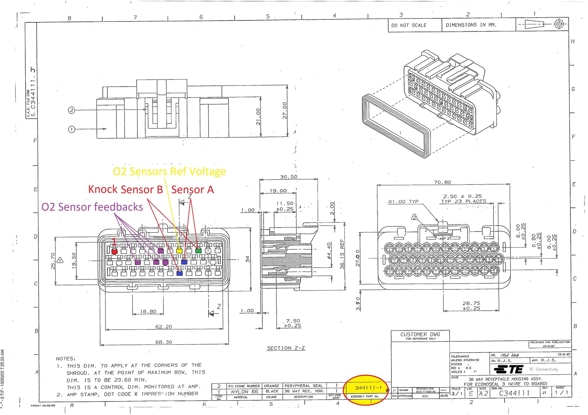

Your original ECU connectors both case and car side can be replaced as readily available TE Connectivity manufacture Econoseal series 3 / size 0.70 part # 344111 - X
The individual rubber seals on each wire can let water through , my seals were missing , corrosion can accrue as the wires are crimped on the sockets effecting the sensors return to ECU signals
