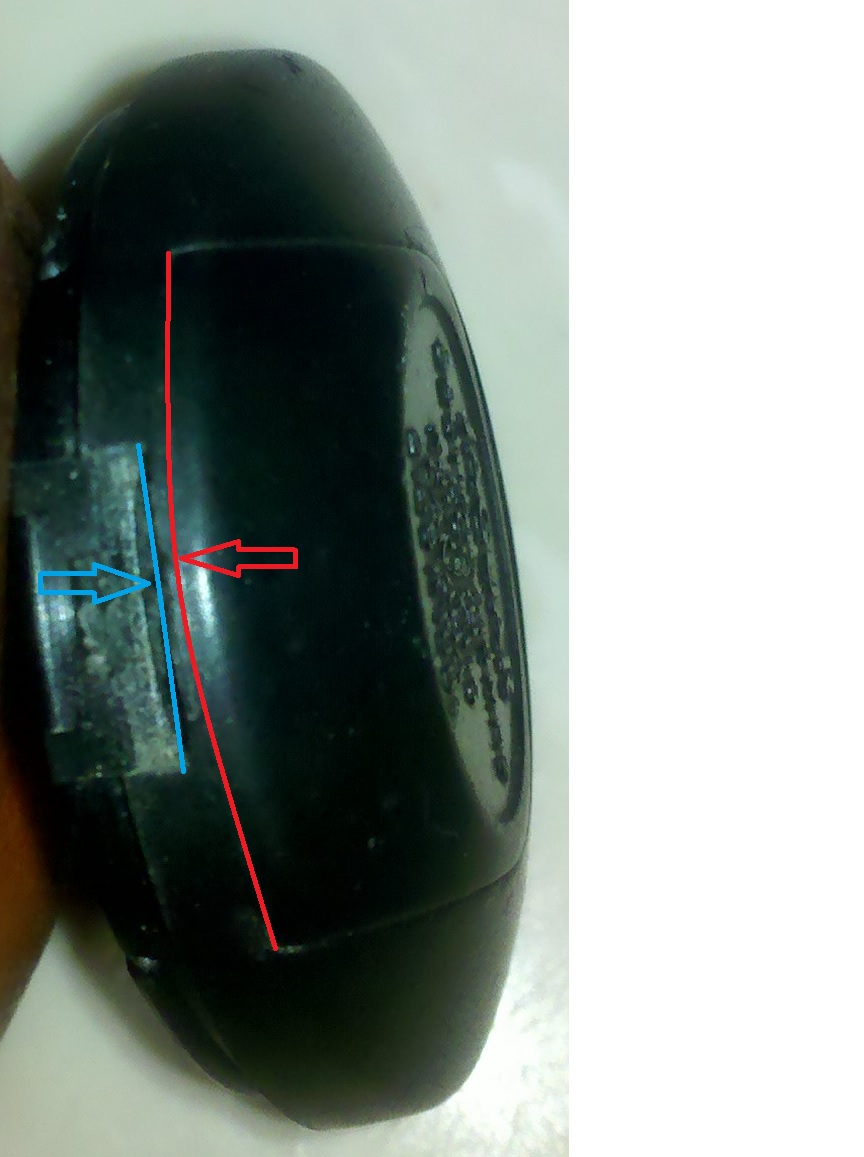

Don't pry it, that'll just separate the halves.
Here's what happened when I used a small screwdriver in the coin slot:
The keen eye will spot a failure in mine which means I'm not at all frustrated that I prised it apart.
The battery cover ends just above the pry-slot: Hard to get it in a position to take a photo, harder still to see the parting lines. I took a stab at marking them in "Paint" but I have rudimentary skills and I think PAINT isn't quite up to the task of what I was trying to do. Still, you see the problem.
As of now, I'm also unsuccessful in removing my battery cover. I'm sure someone will happen along presently with the rosetta stone.

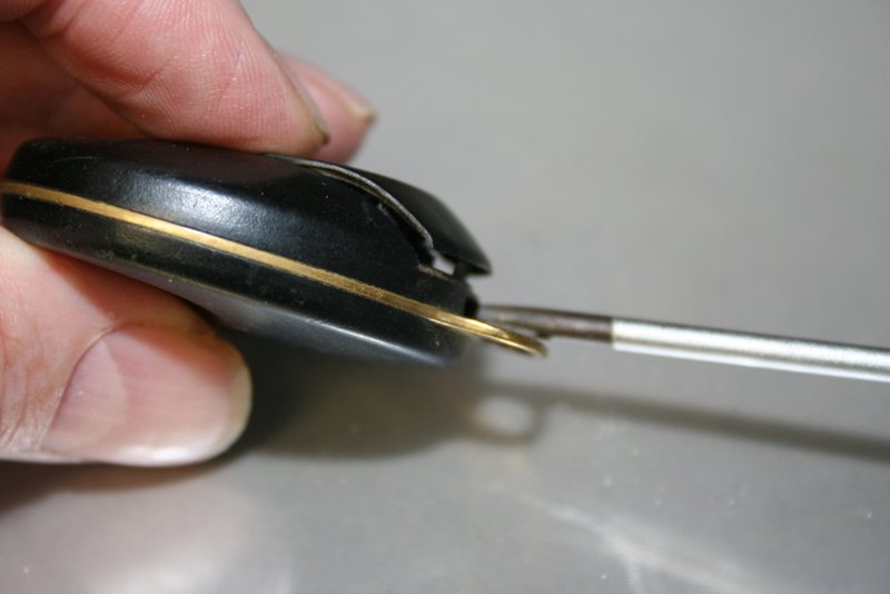

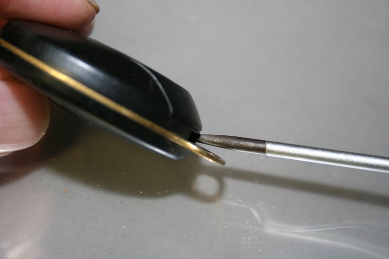

Actually, the cover does not slide out. It needs to be pried (sp?) out. The pictures below should help you understand what you need to do.
Attached Thumbnails Replacing battery in X300 remote fob?  How does one open the remote?-1-img_1734.jpg   Replacing battery in X300 remote fob?  How does one open the remote?-2-img_1735.jpg   Replacing battery in X300 remote fob?  How does one open the remote?-3-img_1737.jpg   Replacing battery in X300 remote fob?  How does one open the remote?-4-img_1738.jpg

A locking tab!
(I've renewed the battery before...just forgot!)
Thanks Brendan, Great Pics!
PERFECT! Now that makes sense, and is actually a better solution than a lot of remotes. Of course unless you know the secret, you're likely to break the thing!
Thanks so much for the photos and explanation.
