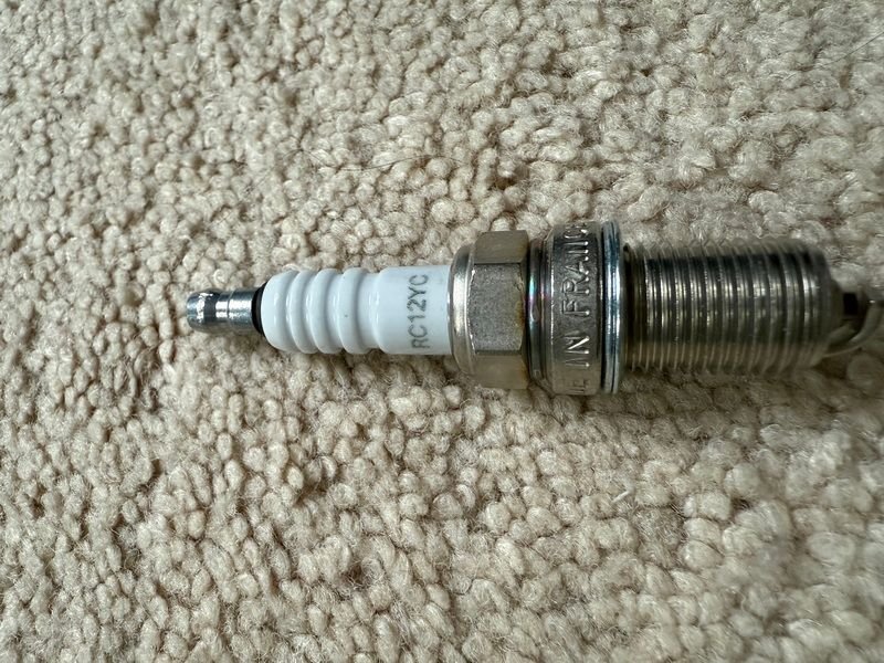

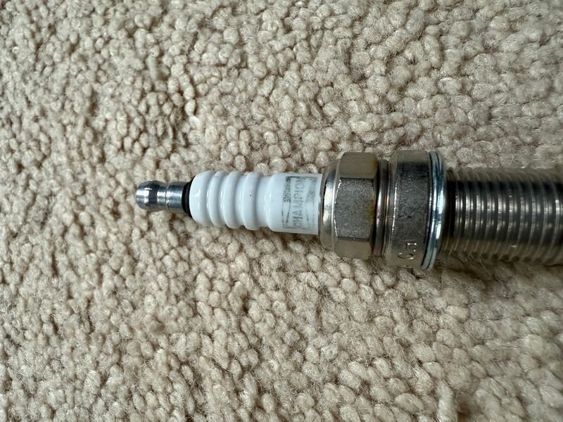

I've recently occasionally obtained a NOS set of EBC8143 which by bulletin should be installed to all 4.0 engines and they look like this

Those are the exact plugs I installed, gapped to .035", run great. Have been advised against the new premo stuff (iridium etc) as they are reported to idle poorly.
