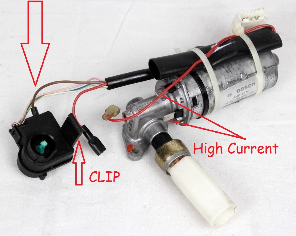

What I found with mine ( frozen ) was that the lubricant inside the tilt position sensor worm gear was dried up causing to much drag on the drive motor . You can simply unclip ( no bolts ) the sensor and clean out the old lubricant and refresh with some new thinner spray . You might be able to do this even without removing the dash panels for it is on the very bottom and very forward on the column assembly . In service the lighter spray may dry out and need the be redone . Graphite may short out the sensor if it migrates in ( ? ) . You'll have to clock the sensor before installing it with the use of a jumper lead on the motor so you don't arch and damage the contact " blades " , lots of current . I used a battery charger as a power source . I did see later that there was a TSB to put in a more powerful motor .
Hope this helps , Parker

So, seriously, if a new column fixed the problem, then it was a real issue (not my over sensitivity per se, arguable I guess) so I wonder what is loose/broken? Anyone ever dive into one to see why the play exists? I'd say mine moves by a good 1/8 to 1/4". Not the end of the world, but one of those little things that bugs ya, you know

SCOTLAD found this
https://www.jaguarforums.com/forum/x...n-x300s-69668/

Thanks, I think that is the very thread I was looking for! I'll give that a try!
