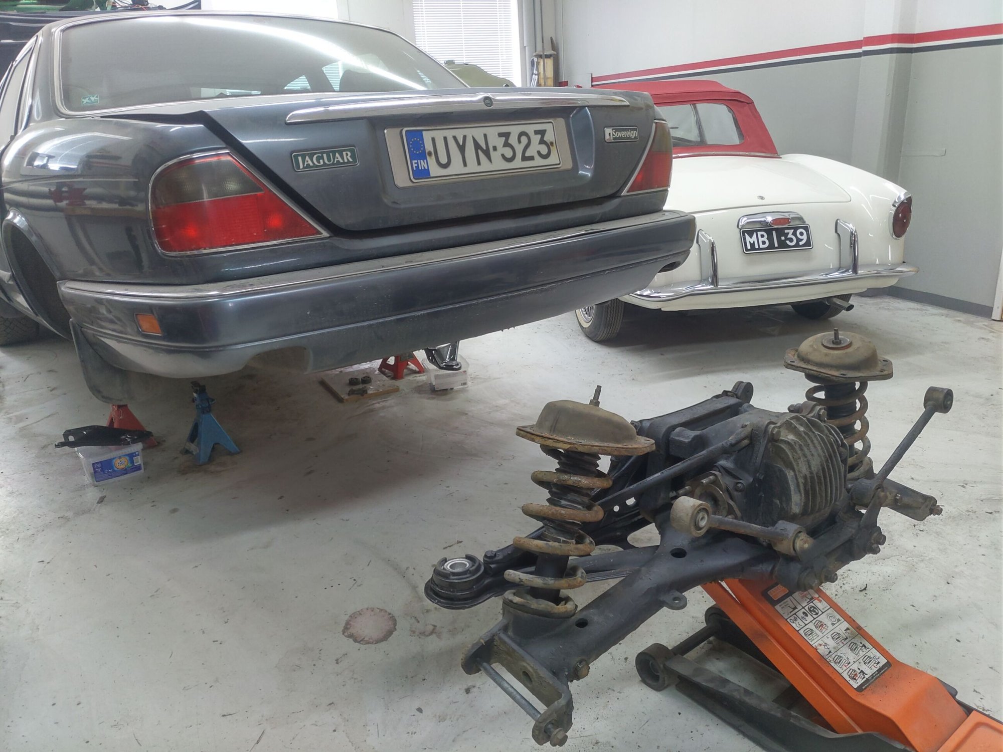

Just did diff rebuild in my tiny garage and i had all parts in hand but did not realise the need. No shims in this car tough.
Hopefully springs come out without removing lower arm. I hate using spring conpessors.

The KYB springs you'll need are RF6742 and you can still find them, they are also in the newest KYB catalogue. You can replace them easily without dropping the rear end, no spring compressors needed, you'll just need to drop the rear frame on each side you'll be swapping spring and rear caliper and disk to get more space to get it out.

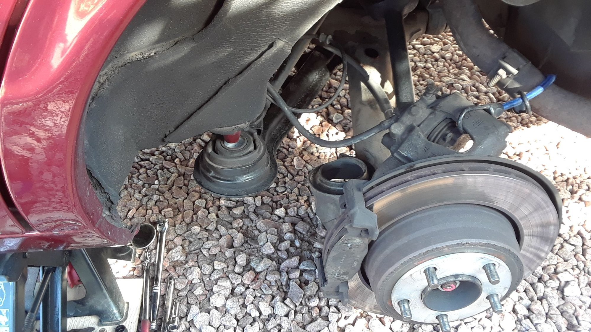

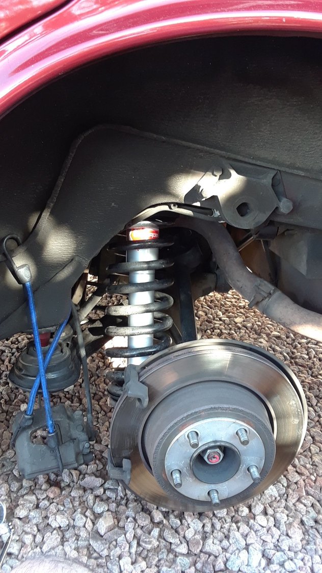

Quite easy once you know what you are dealing with. No compressor needed. Notice brake disc is almost touching ground with the body lifted on jacks.
Releasing the front subframe mount was all that I did (aside from + position of U-joint) to bring the arm down low enough (use hydraulic jack to relieve spring pressure).
Your springs look like the early 7-turn version like mine, which are not as strong as the later 9-turn version which I put in. Though you need even more support back there.
