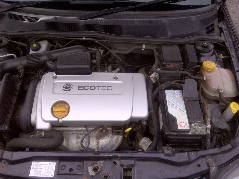

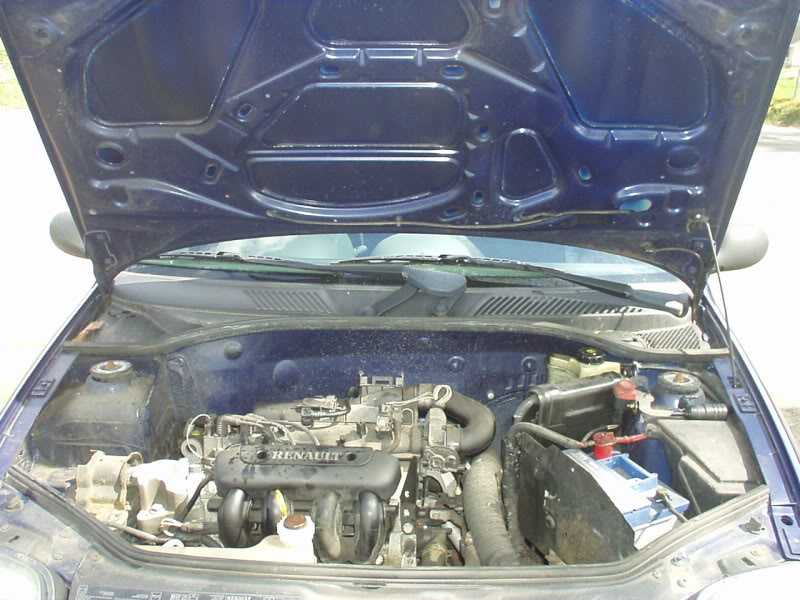

Hi there, really no need to do this.....I've done several cars recently and its so simple.
Cover any sensitive electronics if required with a plastic bag
Using a spray degreaser possibly combined with a hot soapy water solution, simply spray the affected areas and wipe down.
Get yourself an old 2" paintbrush or similar for those nooks and crannies and hard to reach areas.......spray liberally with the degreaser and hot soapy water solution then use the brush to agitate and wipe as required.
You can if required use a slow running garden hose, but it shouldn't be necessary to totally saok the engine.
Once all wiped down, cleaned n dried off you can use a wet n black type product to give the plastics a new lease of life.
I'm not a detailer but have done several cars using this method and got great results, with zero issues
BEFORE....
AFTER....
BEFORE....
AFTER...
Ok so they're not concours standard or perfect by any means but the difference is like night n day......It really depends on what level you want to take it to I guess?
Hope this helps some.......
