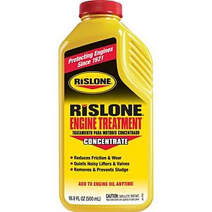

Dude lets do this , remove the spark plugs and put a little bid of Rislone oil treatment in the cylinders and let loosen up the cylinder rings for a couple of days as this is common problem with the AJ16 engine after long storage . It will smoke for a while as you first start it up .

With regards to the cylinder compression rings in storage as a foundation of what the engine needs they may not give you enough compression . Crank over a few revelations without starting to push the stuff ( Rislone ) into the area of interest being how the rings slide apart from the layers of themselves ultimately forming a better axial directed force on the cylinder walls to get you that Vroom Vroom ..................Vroooooo Vrooooom of that advanced AJ16 . Later after you get it started I would put some fuel injector cleaner in the fuel tank

In addition to the Rislone that Lady P mentioned, another product widely used to free up piston rings that may be stuck from long storage is Marvel Mystery Oil. A pump-type oil can makes it easy to put a few squirts into each cylinder and allow to soak for at least a couple of days as Lady P says. You don't need to reinstall the plugs, but set the coils in place to prevent contaminants from getting into the cylinders.
