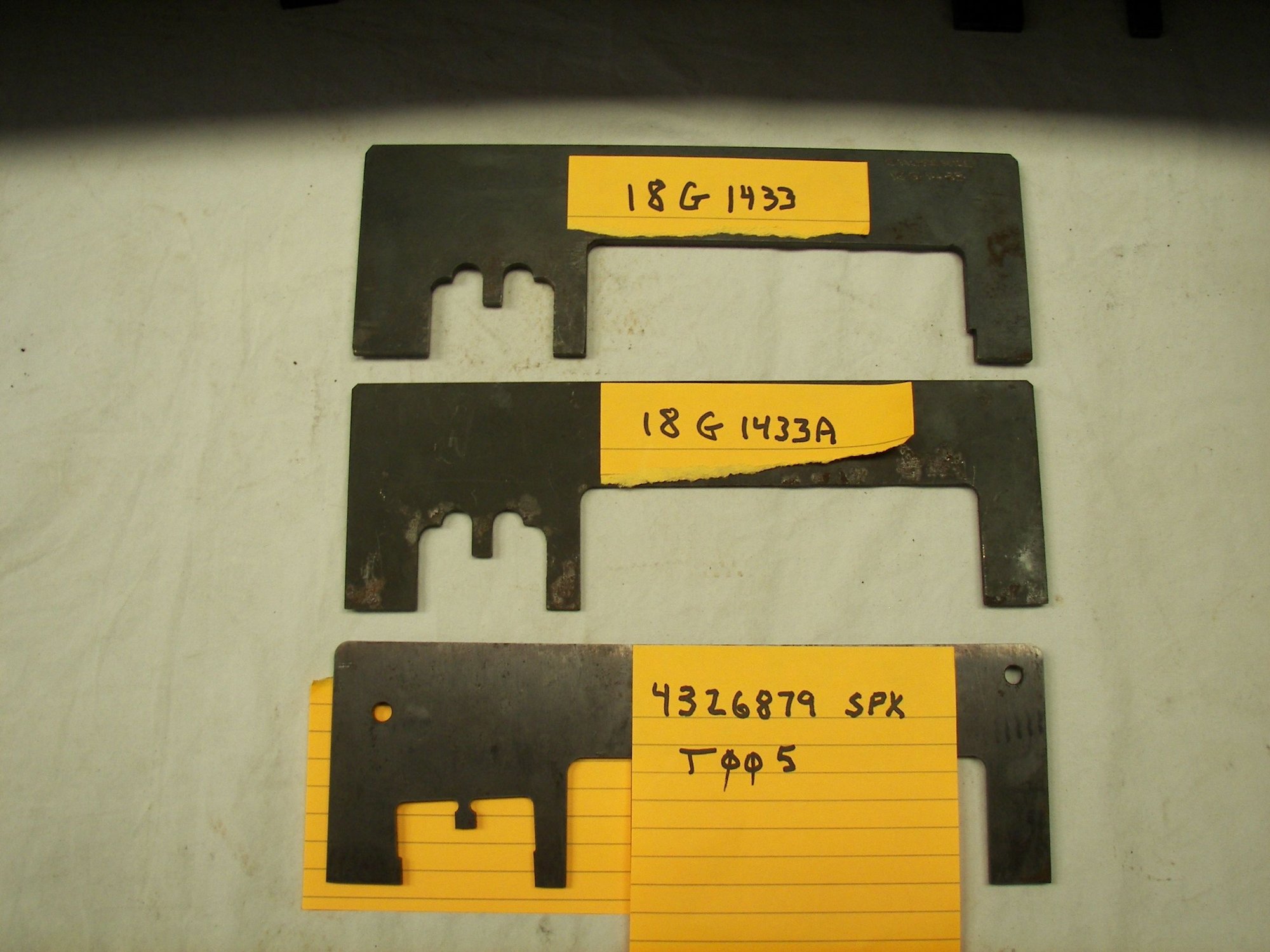

If there is real interest we may place some of these on the Foundations E bay site--we have a few extra. The 18G-1433A and 18G-1433 may be used. Here are pics--the last tool is a mystery to us and we have searched!
I would definitely bid on one of them if the link to the ebay auctions were posted here when they were placed.
