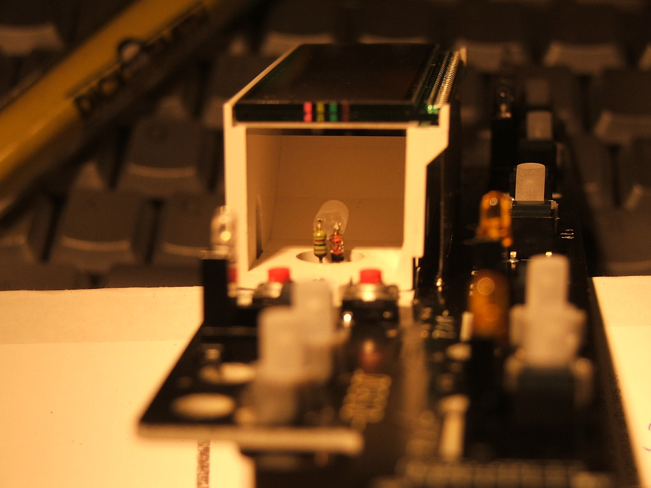

There is a low heat LED bulb Mod to negate the ribbon damage depending on how far along yours is . Be careful in handling the ribbon connection . LED's come in green for better color matching . Don't throw away the original lamp covers / filters as you might try a white LED in a smaller size . 5 , 3 , 1.8 mm wide available . With LEDs polarity matters .
https://www.jaguarforums.com/forum/x...dimming-38712/
Attached Thumbnails watch/clock inside the car-zxe8k.jpg   watch/clock inside the car-eczxu.jpg   watch/clock inside the car-ledsizes.jpg

LEDs will never match the original colour, I must have tried at least 10 different types and its very difficult to get them right, best way is to get standard bulbs, they are called Grain of Wheat Bulbs, 4mm ones are needed and new ones are using 5 times less power than the original ones(~50ma) and they dont overheat the screen cable. Its possible to reuse plastic bases or just use ones from a standard neo wedge bulb.
By the way Sacer(manufacturer of original cables and screens) currently have a sale. If anyone needs a new screen or cable it might be worth checking with them
