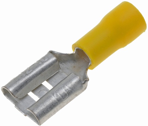

The trunk light attached to the lid commonly nick the wires at the right hinge area . The 2 prongs are deceptive as that side of the blade connector pinches the other half's blade and the 2 curls you see acts as a pinching spring
