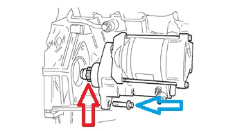

Without actually hearing the grinding noise, two immediate thoughts come to mind:
1. loose Starter Motor securing bolts (lower one arrowed in blue)
2. worn Bendix (arrowed in red) and or damaged starter ring on the flywheel
When the ignition key is turned, the starter motor rotates and the Bendix which is engaged with a toothed ring on the flywheel rotates the engine (apologies if that explanation is unnecessarily basic for you!).
