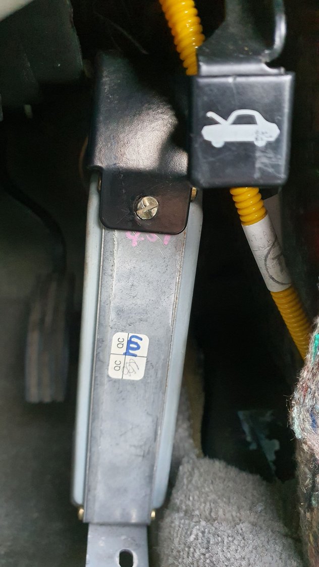

Well I wasn't expecting that! Anti-tamper screws on the ECU. That's put me back a bit. At least I've still got the TCM to try tomorrow.

Cut a slot in the screw with an angle grinder or Dremel to undo them.
