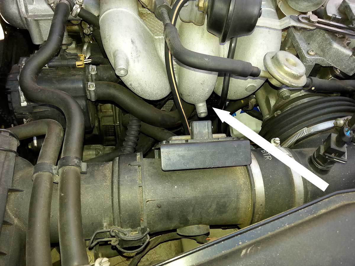

Here's a closer look:https://www.jaguarforums.com/forum/x...enewal-101914/
It's not the lower rad hose, but I covered its renewal in that thread..

Yup, more than likely it's the hose going from the water pump into the water rail. Just had to do it on my XJR about 2 weeks ago. Not a hard job, but just A LOT of things are in the way to get to it.
I didn't bother totally removing the whole intake since I didn't wanna go through the trouble of disconnecting all harnesses underneath. Just moved the entire front section of the intake manifold out of the way and just enough to get to the house. The hose, you can find on Amazon for about $15 or so. But I was able to get a similar hose with the slight angle bend for $8 at my local autozone. Just had to cut it a little shorter.
Doing it on a regular XJ6 is a whole lot easier compared to the XJR but it's the same concept...
