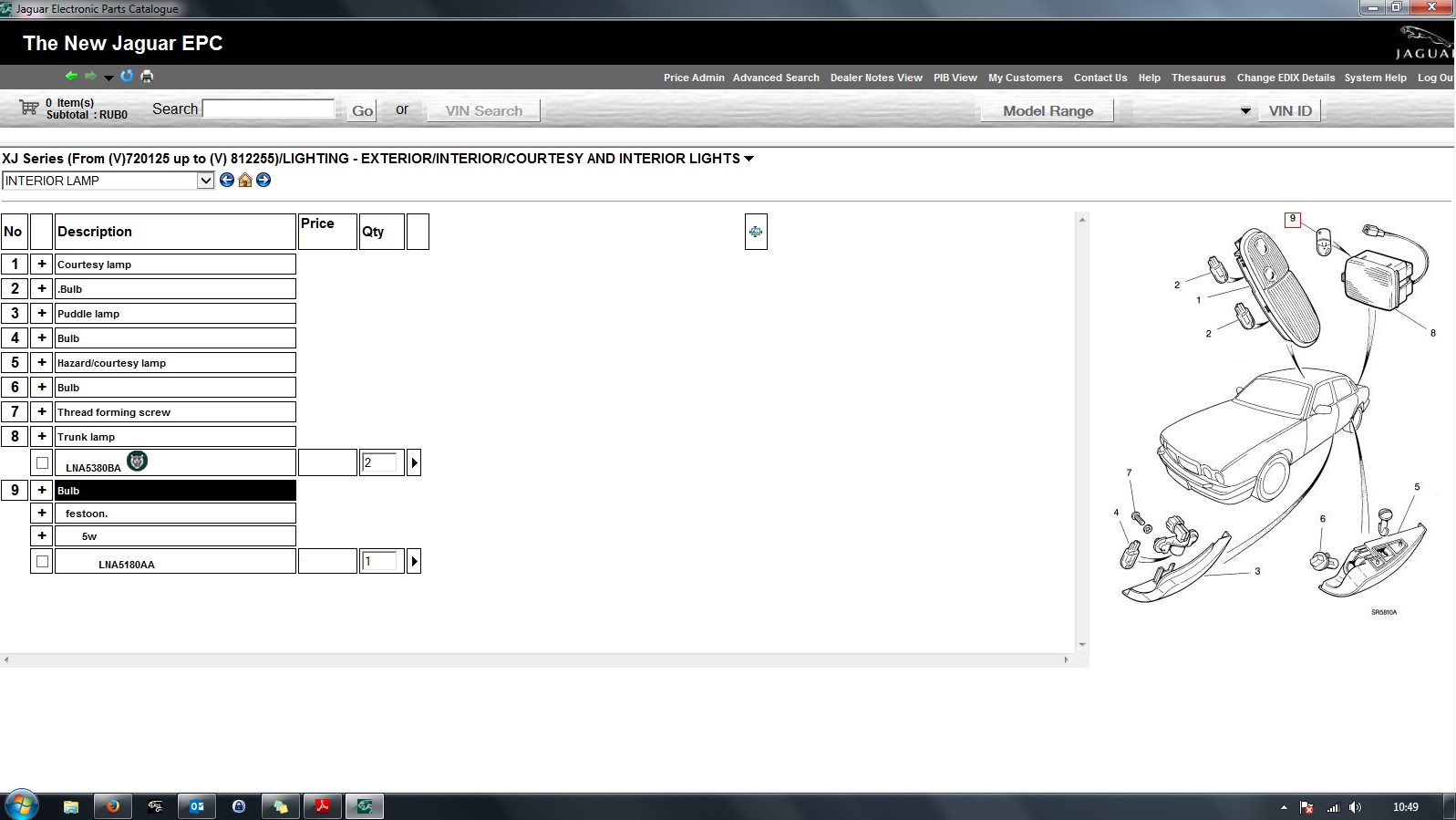

To add some detail to the thread, here's the Number Plate Lamps info from the Parts Catalogue:
X300 number plate lights - is one only a dummy? (RESOLVED)-x300-number-plate-lamp.jpg
And another regular culprit for disappearing behind the trim, the Luggage Compartment Lamps:
X300 number plate lights - is one only a dummy? (RESOLVED)-x300-luggage-compartment-lamp.jpg
