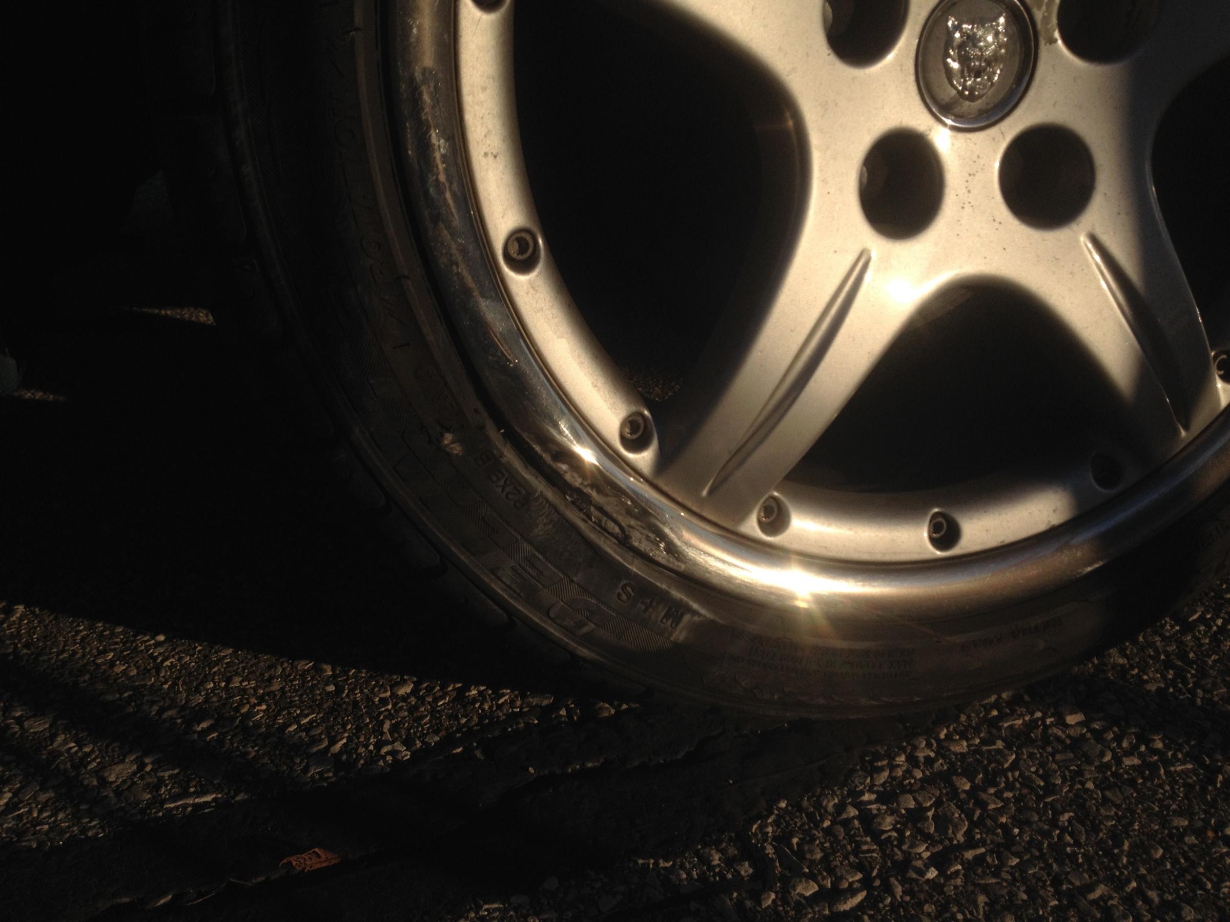

Ive run into some trouble... I was driving my xjr and hit some black ice, spun the car and the rear end smacked up against the curb wrecking the rim and further causing damage to the rear suspension. Its totally shot. ( I thought the wheel was going to fall off when driving it to the shop)

Im not quite sure how to send pm's but ill try to figure it out, i would like to check out the rear suspension you have. Also i am going to try to upload some pictures of the damage on my car.
Maybe it'll give you guys a better idea of what went wrong and what i need to fix it.

So you kissed both ends of the car?
You need to get a view of the underside of the rear suspension.
It may be that the bearings are collapsed or shattered. The bearings are
inner and outer on the halfshaft which forms the upper arm of the
suspension as well as four bearings each in the two u-joints. None
of them are extraordinarily difficult or expensive. The u-joints are
standard chevy u-joints.
The bearings are especially suspect if the wheel sounds terrible while rotating.
A bent suspension arm is not especially noisy. The wheel still rotates, just at
the wrong angle.

Unfortunately i did hit both sides (riverside front wheel and tire, passenger side rear wheel and tire)
But that is good to hear, i was thinking id be out a couple thousand on the damage. I have the car at the shop right now. So its getting checked out and ill see what i need exactly.
But like you were saying, when i moved the car around, the wheel made noise when rotating. Hopefully the parts you mentioned is what i need, and nothing else or nothing major that will empty my wallet haha!
