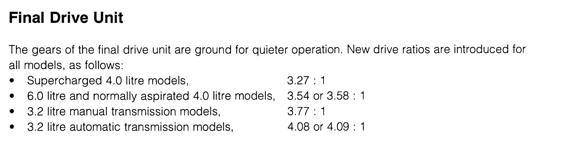

No it would not. And anyways if your having 4.0 car with automatic that should be already 3.58:1
I always thought the ratios are as below
  • XJR auto (and manual?) 3.27:1
  • 4.0 auto 3.58:1
  • 3.2 auto 3.77:1
  • 3.2 manual 4.09:1 ? (last one I am not sure )
but Jaguar tech doc "XJ6 and XJ12 range 1995 model year technical introduction" list the ratios as follows
but anyways 3.54 , 3,55 3,58 should not make anykind of a differense in my opinion.
