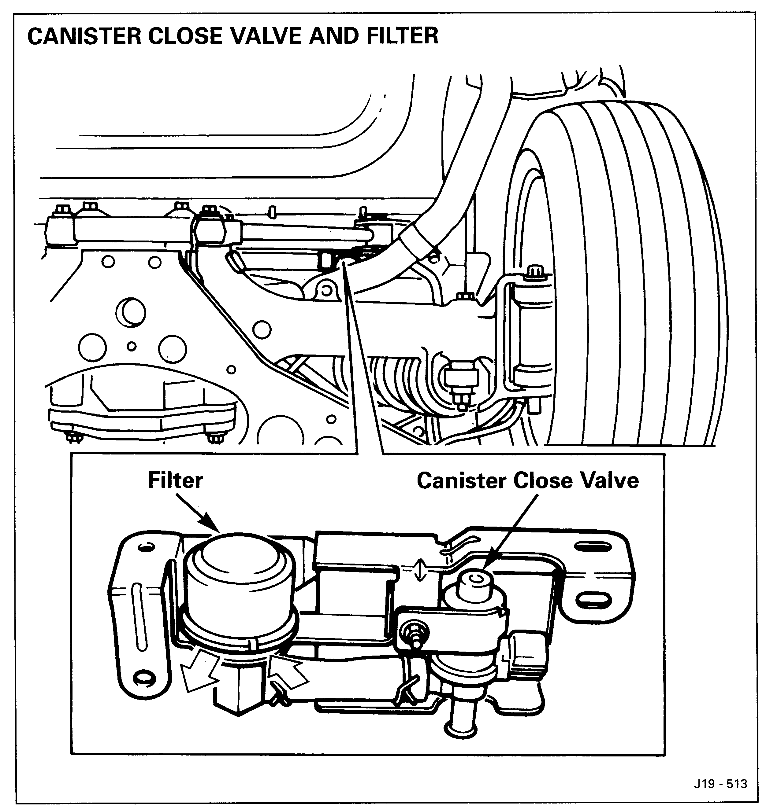

The EVAP valve taps into the MAF sensor wiring . Possibly the EVAP us sucking the MAF signal down . Try disconnecting the EVAP valve located under air filter assembly . Run the engine at idle and see if you read the 1.2 volts on the center ( Green / Pink ) wire of the MAF
For non - S/C engines the shared wire also goes through the Canister Close Valve through connector Papa Indy 161 pins 1 and 2 . This valve not always installed .
Also check the ECU connectors for corrosion
Attached Thumbnails XJR6 Awful Fuel Consumption-x300-canister-close-valve-untitled.png

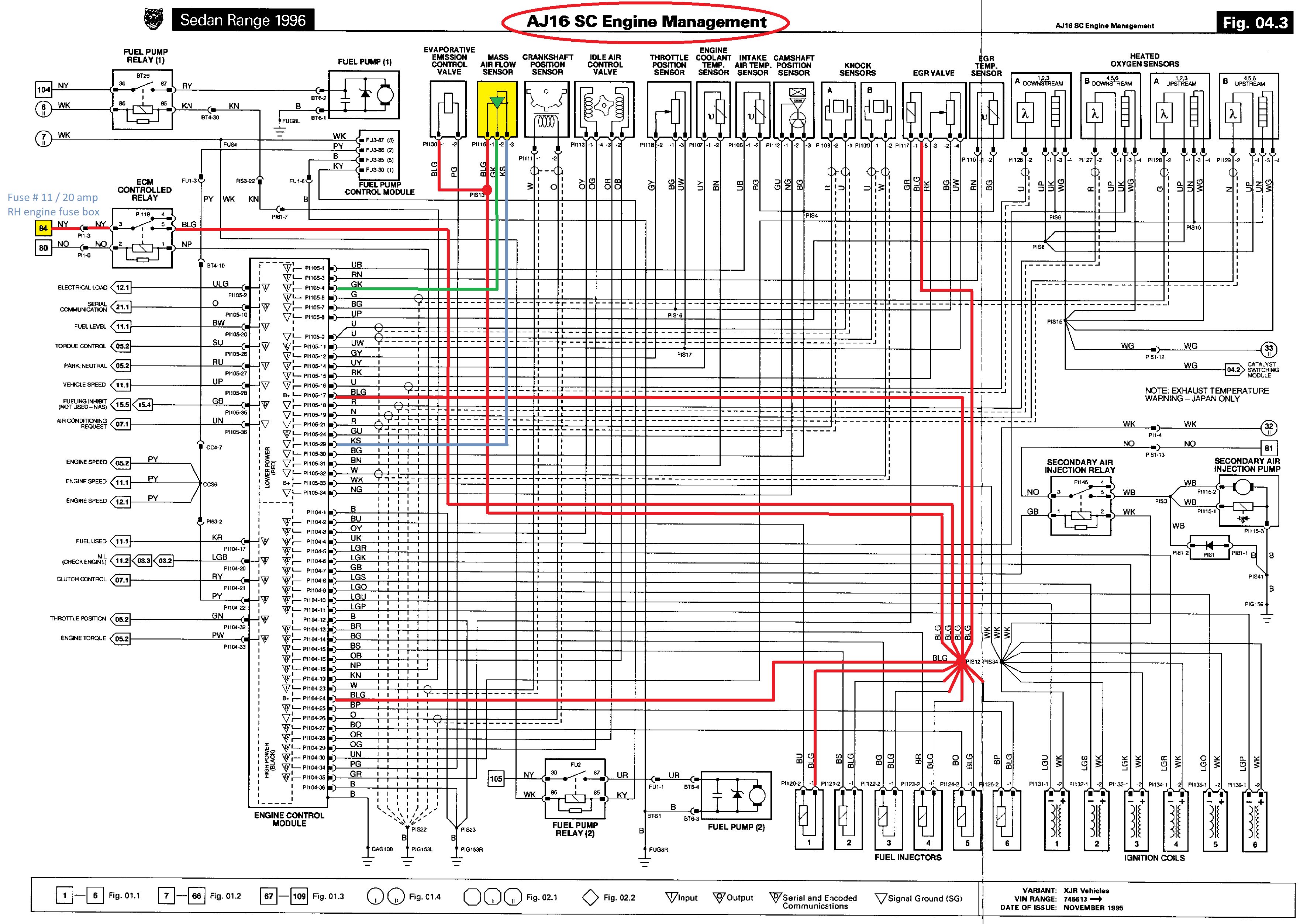

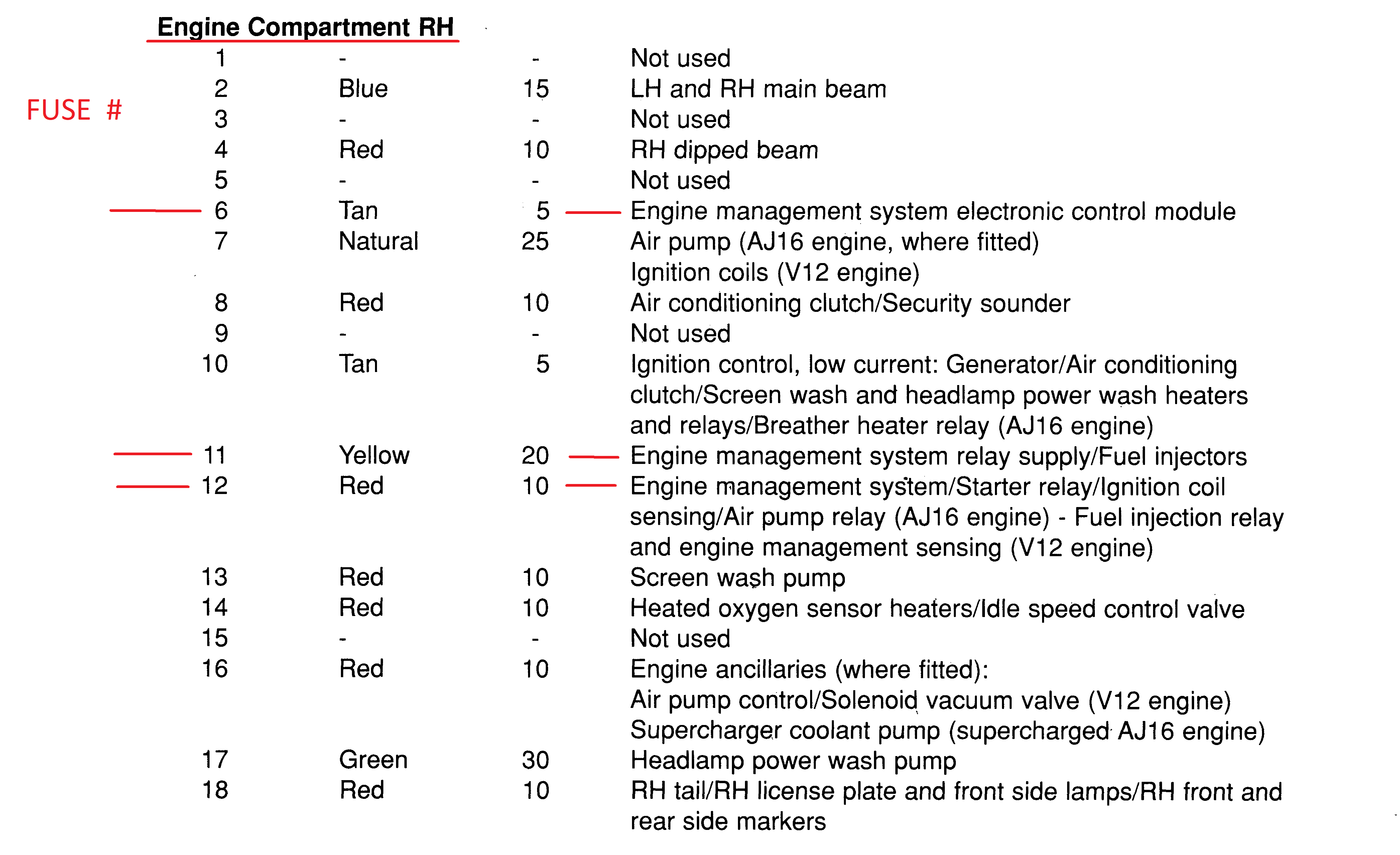

Something is not right , the sensor and injectors pulse width should be feed by a fixed reference voltage as B + changes . My Brain Hurts
I did find an error on the EGR valve pin location / wire color on my Lady P . as I have wrang all the wires on the engine harness before .
Papa Indy 104 - 24 and Papa Indy 105 - 17 are not listed in the wring out sheet as to their values .
Hi Lady P,
What I interpret from the schematic is that the BLG circuit supplies B+ voltage via the fuse you note and the ECM-Controlled Relay to the injectors, MAFS, EVAP Control Valve and EGR valve. The connections to the ECM in both the High- and Low-Power sections allow the ECM to monitor B+ voltage. According to the EMS manual, the ECM operates each injector by connecting it to ground/earth, and it adjusts the pulse width in response to the current state of B+ voltage. I assume but have not confirmed that the ECM may also adjust its interpretation of sensor values relative to B+ variations.
