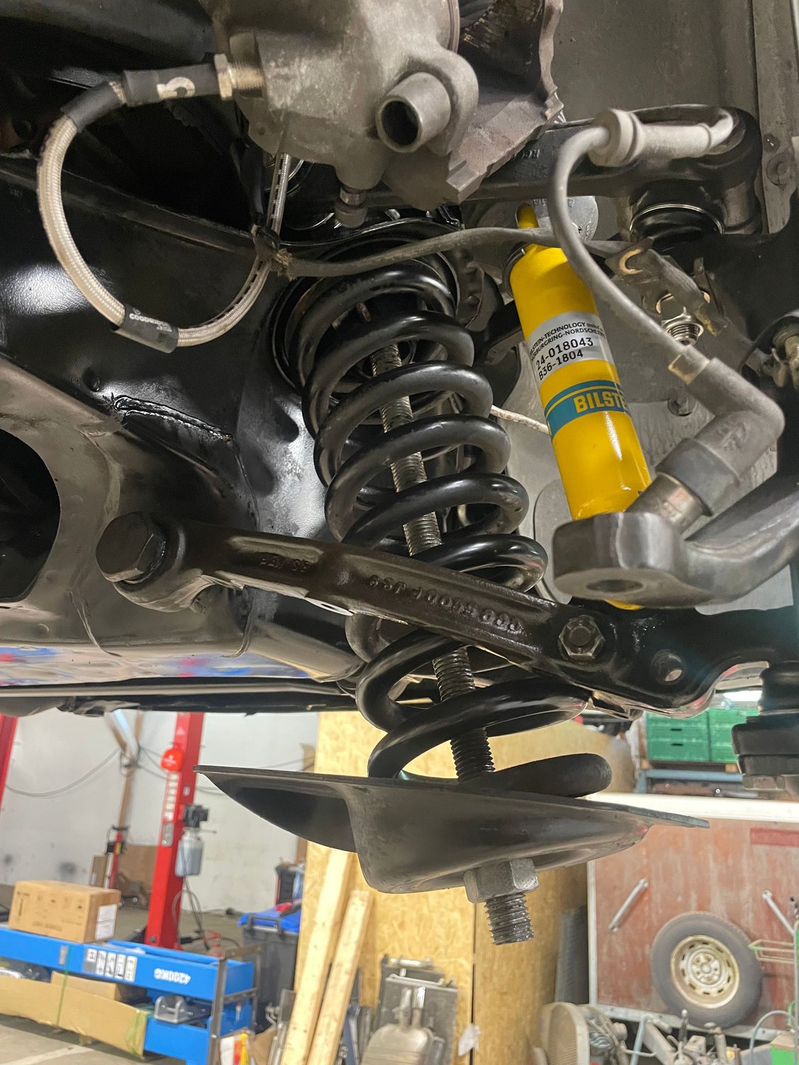

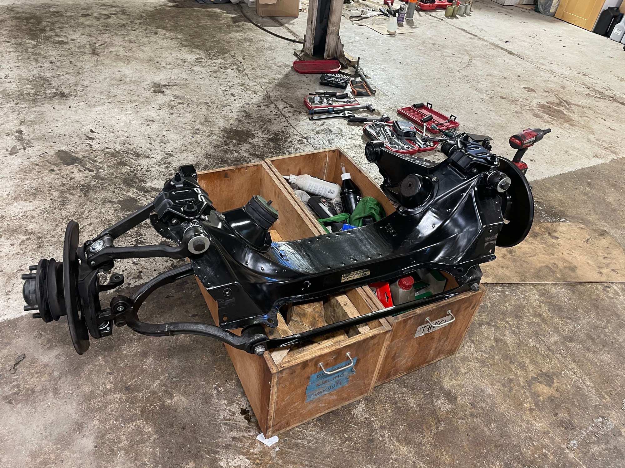

I recently rebuilt the entire front suspension, including new bushings on the subframe, and that completely cured the tramlining on my car, so if you have that problem i suggest you take a look there first.
Also install some bushing spacers or wind some steel wire in the bushing gap to cure the excessive sideways movement of the steering rack.
I run 255/45/17 Toyo Proxes sport tires, and i would say the ride very much magic carpet style comfy - before changing the bushings it was a little bit on the harsh side.
edit: i used the rather expensive Original parts, not URO, except for the upper control arm bushings and lower shock bushings which were polybushings.
