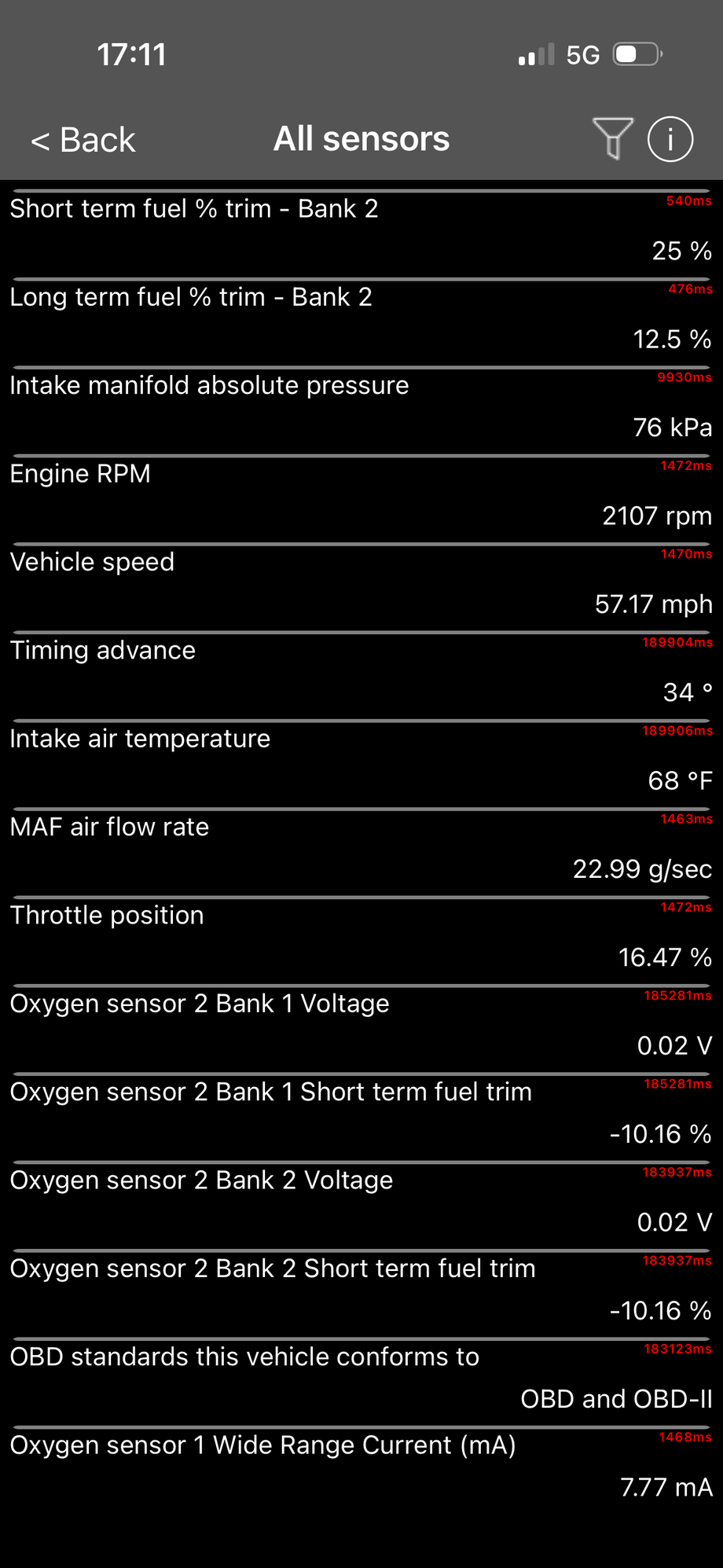

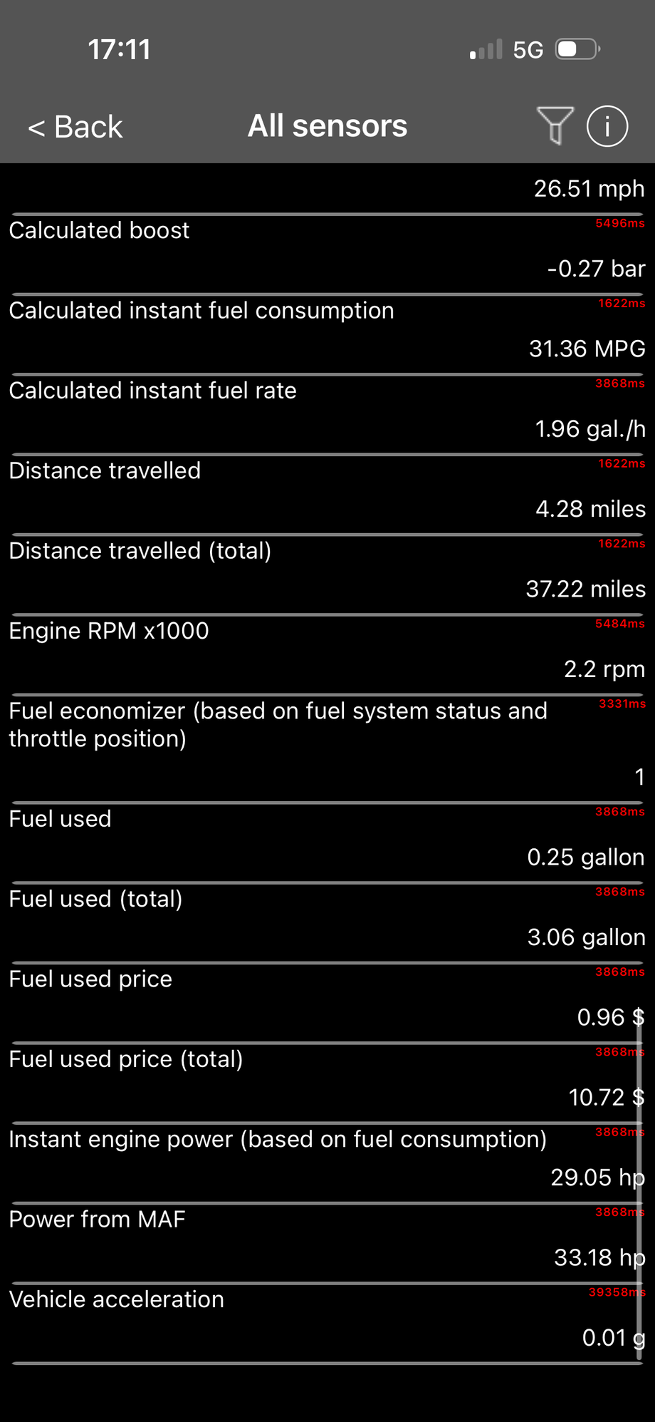

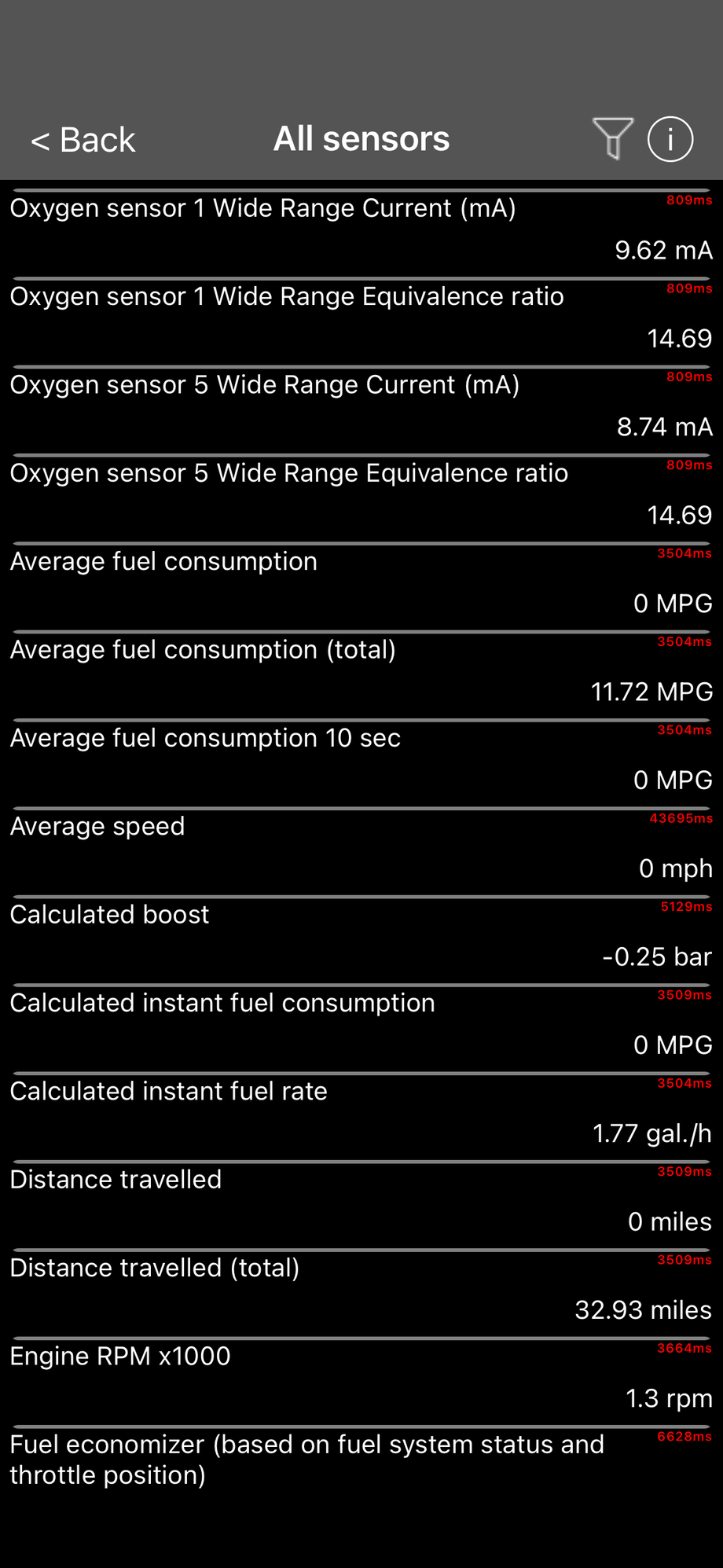

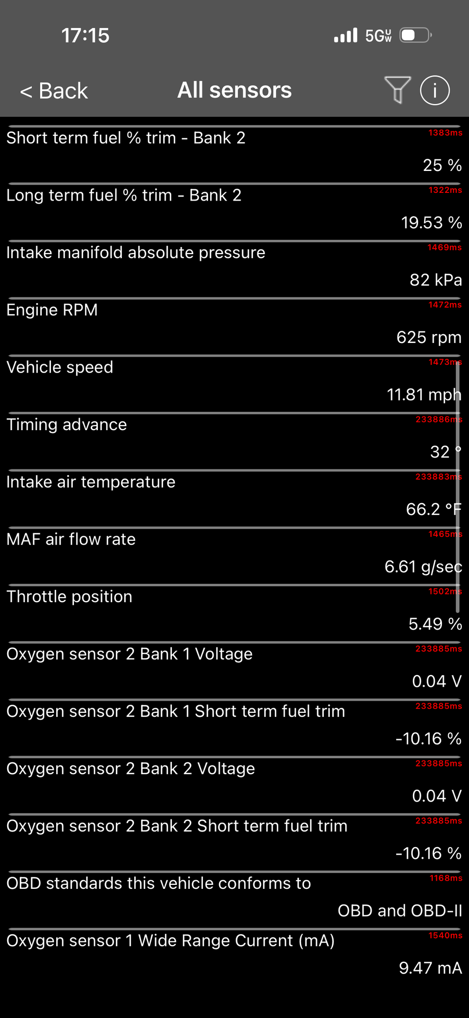

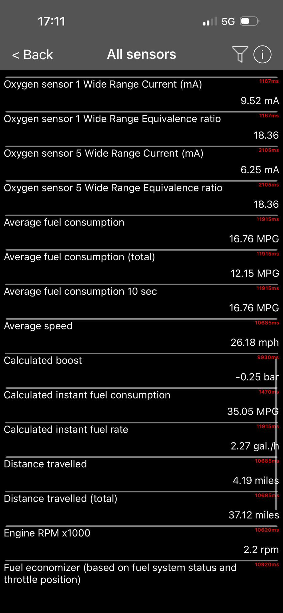

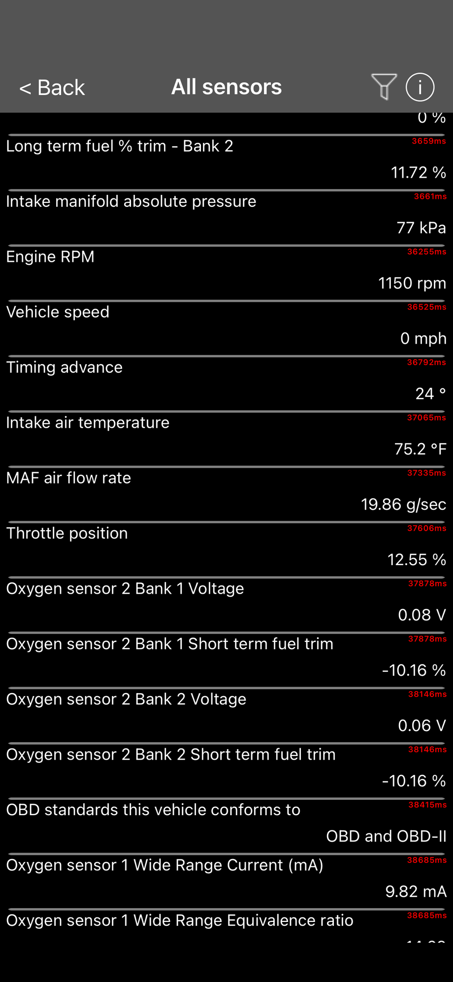

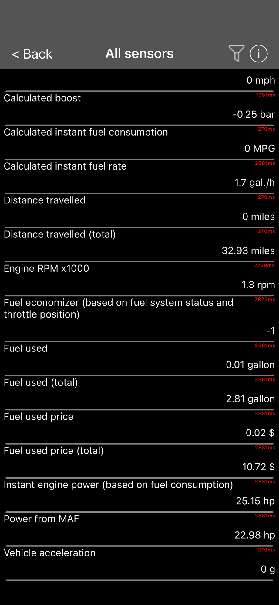

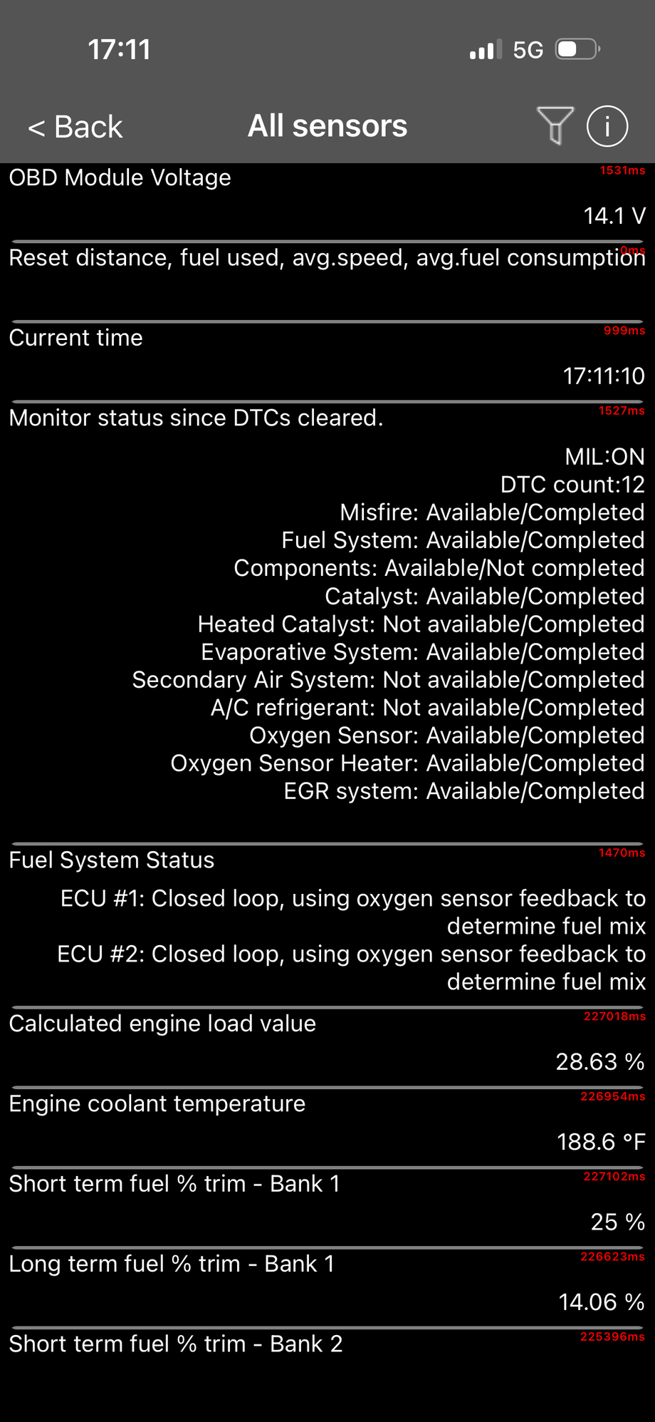

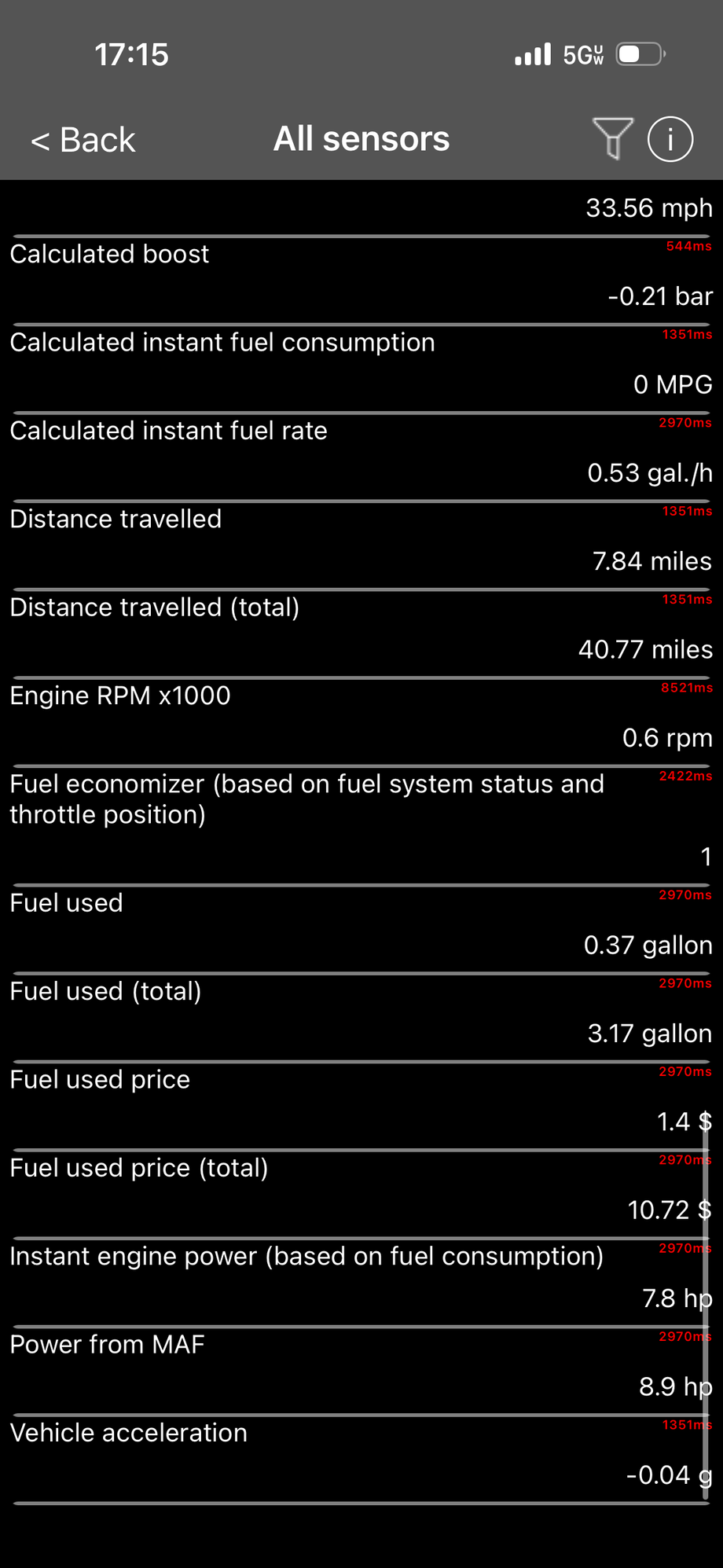

okay today I have 2 bottles of Heet in, shaken not stirred, let it sit 2 hours, still stalls when starting from cold but if i put my foot on the gas a little and wait 30 seconds it evens out and stops stalling. It shakes but after driving 2 minutes shakes much less than before. Still accelerates and drives the highway as if nothing is wrong aside from the heavier deceleration.
I took live readings to share while cold idle, hot highway driving, and hot idle. I only understand a few of these statistics, like i can see that the alternator is working. I can see the timing advance seems normal which means no slipped teeth? I don't know what fuel trims should be and I understand that would be a piece of this puzzle.
Cold idle page 1
cold idle page 1
cold idle page 2
cold idle p2
cold idle p3
cold idle p3
cold idle p4
cold idle p4

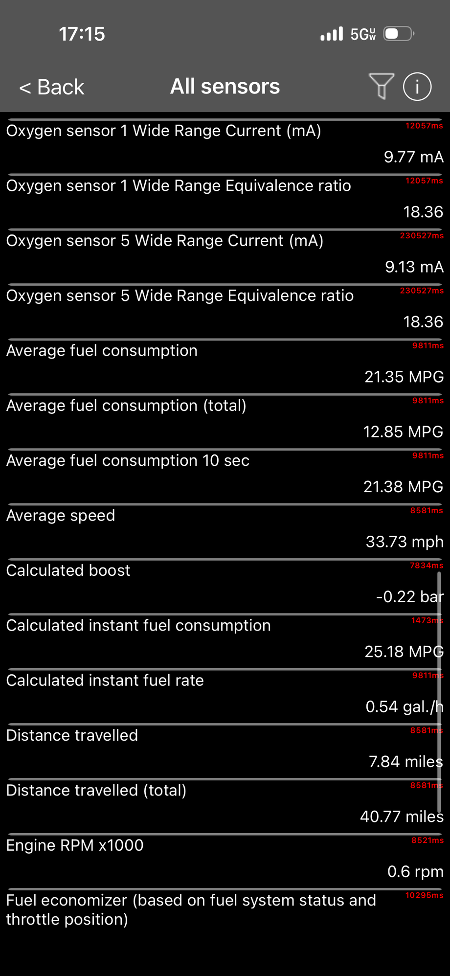

Default hot highway driving stats
when driving on the highway up to temp:
Old Nov 9, 2025 | 11:16 PM
ThatsNoMoon's Avatar
Joined: Aug 2015
Posts: 83
Likes: 20
From: Long Beach, CA
Default hot idle
when idling at a light after highway, up to temp:

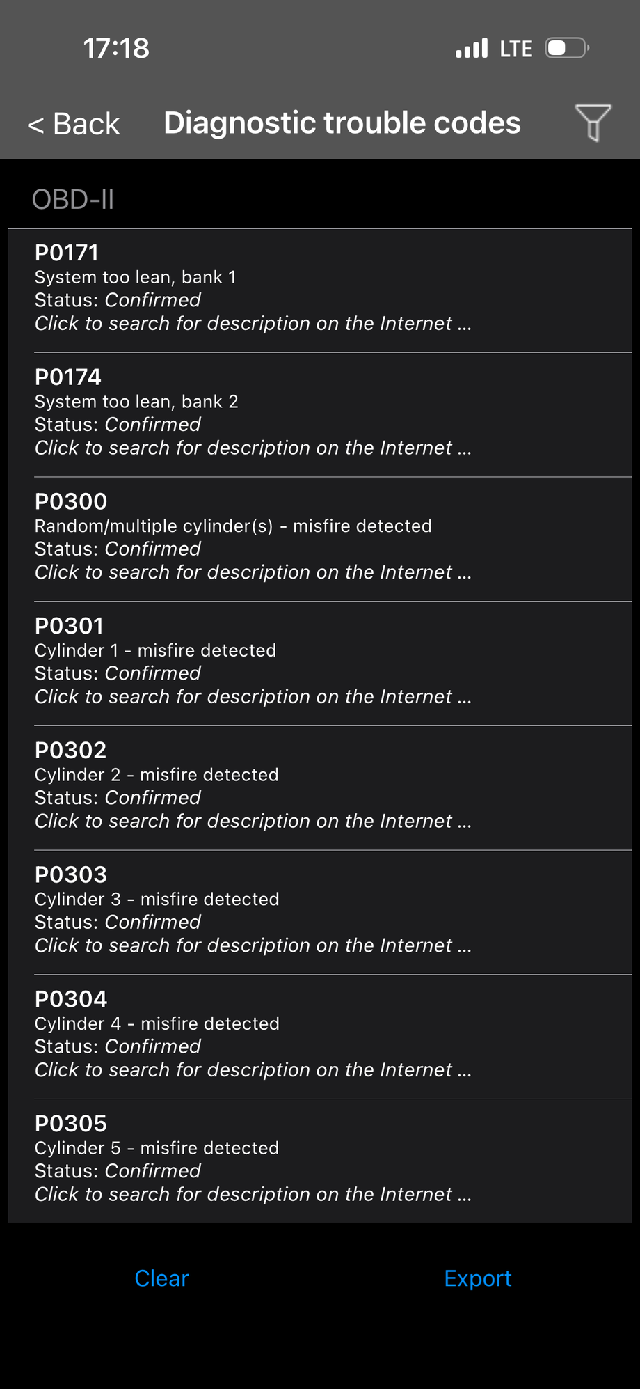

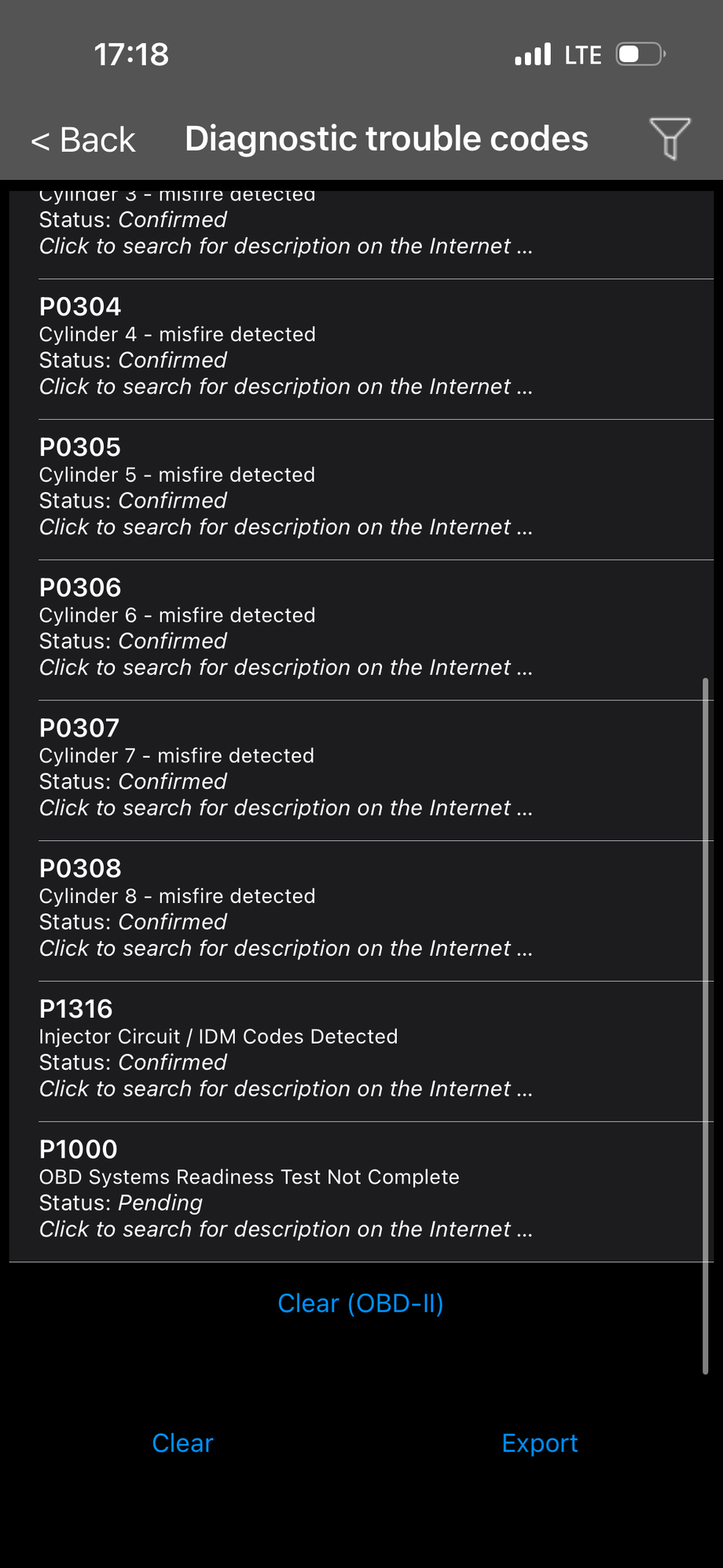

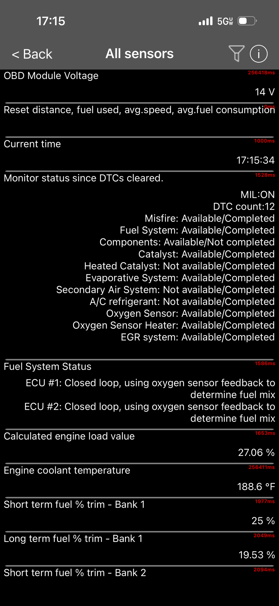

Default current codes
and here are the codes at the moment.
again - seems to be improving slowly and i don't know how quickly to expect $20 of bad gas followed by a fill-up of good gas, injector cleaner, and Heet to work its way through.

Old Nov 10, 2025 | 07:11 AM
Hooli's Avatar
Joined: Sep 2019
Posts: 1,190
Likes: 674
From: Doncaster, UK
Your fuel trims look very high, I've seen within 10% of zero stated as the safe range to show nothing is wrong.
Considering they are showing 25% & higher extra fuel, yet you've got lean codes suggests some sort of issue. I'm not sure where I'd go with that, I'm sure others will have ideas. I suspect a fuel pressure test might be an idea at the rail, as a blocked fuel filter would make the car lean even when it's massively increased the injector timing (as per the trims) to try & compensate.
FYI, injectors flow at a set rate, so for more fuel they fire for longer. This of course relies on the correct fuel pressure so they deliver the amount the ECU expects.
Old Nov 10, 2025 | 10:05 AM
Joined: Aug 2015
Posts: 83
Likes: 20
Originally Posted by Hooli
Your fuel trims look very high ~~
Thank you for thinking it through! And for teaching me what fuel trims "actually mean".
I installed a new fuel filter when I changed my pumps two months ago. I never buy cheap parts but... could be that the material or structure collapsed inside and is blocked??
I'll pop out each fuel pump relay to check both pumps, and report back later today.

High positive fuel trims are consistent with water in the fuel, which causes the oxygen sensors to see a "lean" condition because less actual fuel is making it through the injectors due to the presence of incombustible water. The ECM is extending fuel injector pulse times to add more fuel, but because of the water, the oxygen sensors are not reporting the expected change in air-fuel ratio (AFR), so the ECM keeps adding more and more fuel until it reaches the limit of its adaptation capability, typically +25%, at which time lean running Diagnostic Trouble Codes are triggered.
The Heet is denser than fuel and settles to the bottom of the tank, where it intermixes with the water and forms a partially-combustible mixture. While the water/fuel mix is working its way through the system, the engine will continue to run roughly until all of the water has passed through the engine. Depending on how much water was contained in the bad fuel, it can take 100 miles or more for it to work through the engine. A good extended drive at highway speeds usually helps accelerate the process.
If you don't notice a difference after 100 miles or so, further diagnosis will be required.
