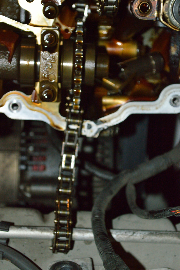

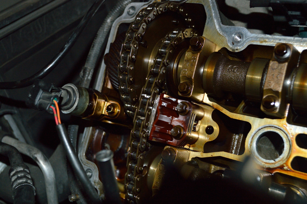

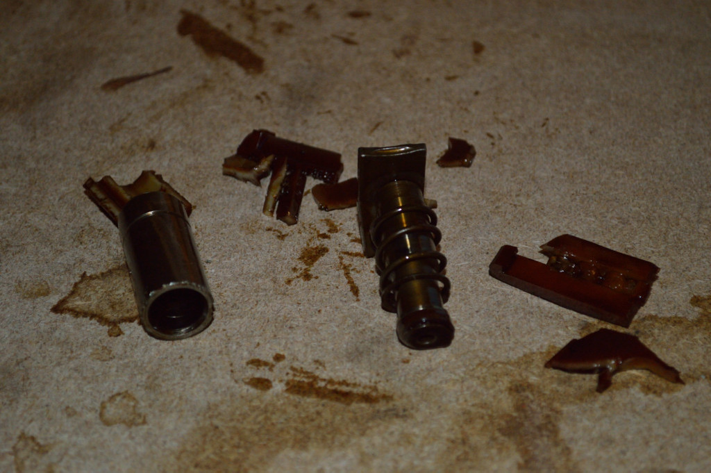

Hi All,
Thanks for everyone's input. I've started with Bank-A, and the secondary chain has snapped as well as the secondary tensioner disintegrating :-( Next step is to start on bank-B, remove timing covers and replace timing components (and of course, start collecting all of the bits of plastic from head to sump).
Here's some photo's for others to see if interested.
Regards,
Beaky.
Regards,
Beaky.
Last edited by beaky; Jan 2, 2015 at 04:05 PM. Reason: Larger photos of damaged Bank A
Man!....you have been pretty lucky so far.;o]
Your engine being an AJ27 model (solenoids sticking vertically out of cam covers) will have the second gen. tensioners which are still plastic.
The third and fourth gen. are the alloy bodied ones.
Judging by the colour of the cylinder heads, I would suggest this engine has not had oil changes too often and using poor quality oil which tends to exacerbate the problems with the tensioners and this design has a high loading
on the tensioners due to pretty radical cam phasing.
If this was my engine, I would be removing all four cams, remove plugs and do a compression test on each cylinder with a compressed air operated leak down tester...this should tell you whether any valves are bent without having to remove heads.
Or, you can do the same thing with a boroscope.
You can leave the intake cam in place to do a quick compression test.
The exhaust valves won't be opening but you should get a reading of 'more than ZERO'. The 'intact bank' is probably fine so I would not worry about that side for compression test.
Just remove the exhaust cam with the broken chain or visually look at the lifters to see if they have the correct lash.
If you see EXCESSIVE 'valve lash' then you will need to remove the head for repair.
bob gauff
bob gauff
