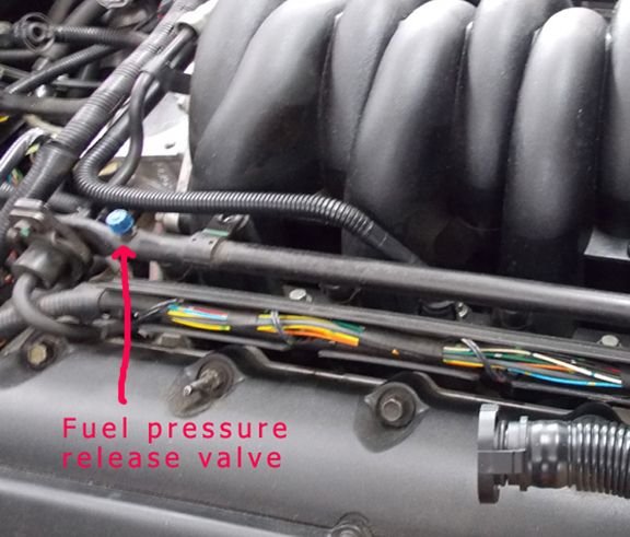

To check the fuel pressure at the injector rail, remove the airbox top and intake tube and remove the plastic engine cover. You can now see the fuel rail and blue-colored Shrader valve cap.
With the ignition on, unscrew the cap and depress the Shrader valve to check for pressure. Have rags available to soak up any gasoline if there is pressure.

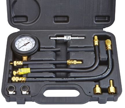

You can also check for pressure using a gauge set, with the ignition on there should be approx 40psi of fuel pressure in the fuel rail. Harbor freight has a good gauge set for just $25 bucks.

Thank you all, once again. I depressed the Shrader valve, and a tiny tiny amount dribbled out while the ignition was on. Not even enough to wipe up. My next decision is to convince myself to troubleshoot, or replace, the fuel pump. Not sure where it is, but I'll check voltages going to it first. Thanks to the 3 people that helped.
