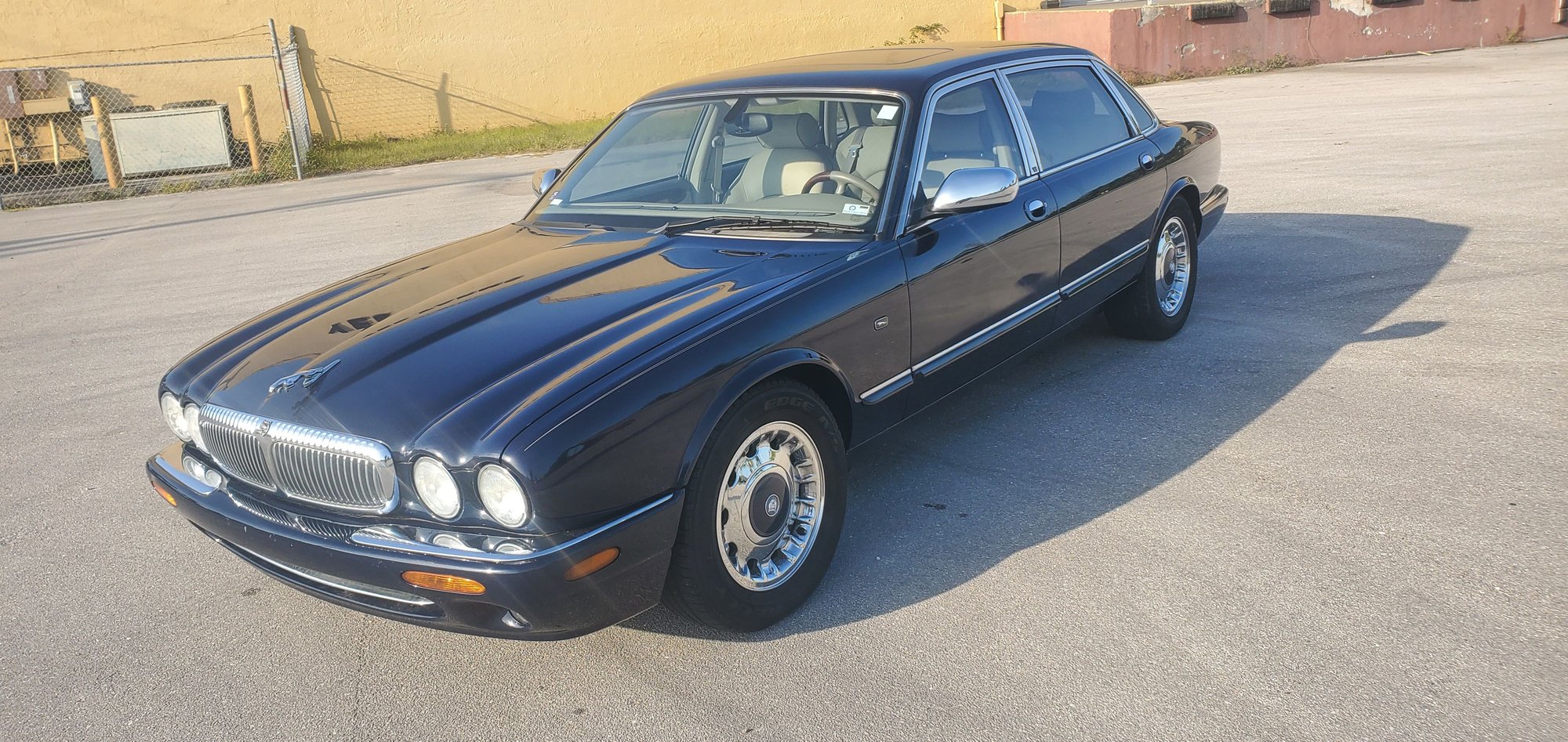

2000 XJ8 VDP with only 40k miles on it
Old Mar 6, 2023 | 07:40 PM
Goldmandan1976's Avatar
Joined: Jul 2021
Posts: 68
Likes: 12
Default 2000 XJ8 VDP with only 40k miles on it
Hello everyone. I just bought my 5th Jaguar, this one was sold to me by a friend of mine. This car had sat in a garage for the last 4 years at least and not driven, luckily the fuel tank was almost empty, showing less than 1/4 tank on the gauge. We pumped out what we could and the low fuel indicator did come on the dashboard. We proceeded to put fuel injector cleaner, octane booster and also HEET water remover in the tank and then filled about 10 gallons of fuel. The engine starts right but but hesitates/misfires. There were some misfire codes that came up on the scanner, I replaced all the plugs and all the coils. Only code that remains is P0341 cam position sensor bank 1 out of range. That cam sensor was replaced by my friend. I have read on several Jaguar threads that the "camshaft position sensor" in question is the one at the front of the engine, the VVT solenoid. When i first drove the car down the street it barely moved under it's own power, bucking and jerking. Then I put more gasoline in the tank, and feathered the gas pedal, it seemed to run smoother.... by the next traffic light it was even smoother, and 2-3 minutes later I was doing about 50 mph and it felt fine, However the reduced performance light came on but then went away after continued use. So right now I have that intermittent "reduced power" message/mode coming up and there's a low coolant message. I did smell coolant when it was idling, no overheating or any indication of the temperature rising. Any common spots to look for leaks on the 4.0 V8?? Any clues what may be going on here?? Oh, I also forgot to mention that at times when i step on the accelerator it tries to bog out, then i let go of the pedal and feather the gas and it responds I thought I had read there was issues with the throttlebodies or the position sensor?? Also know about the timing tensioner issues, but at 40k miles should I be worried about any of these timing components? I have it on my To Do list but hopeful that I can drive and enjoy the car first before having to dig in and do the timing component upgrade
Any help is greatly appreciated!!
Dan

Beautiful car! Never seen those rims before.
I think the wheels are called “Crown” but the dark centre Daimler hub caps set them off more than the typical light ones.

The wheels on this car had a sticker price of $6900 when new! Unbelievable!!! They have color coded center caps with the same pinstriping as the car itself. Very tastefully done
