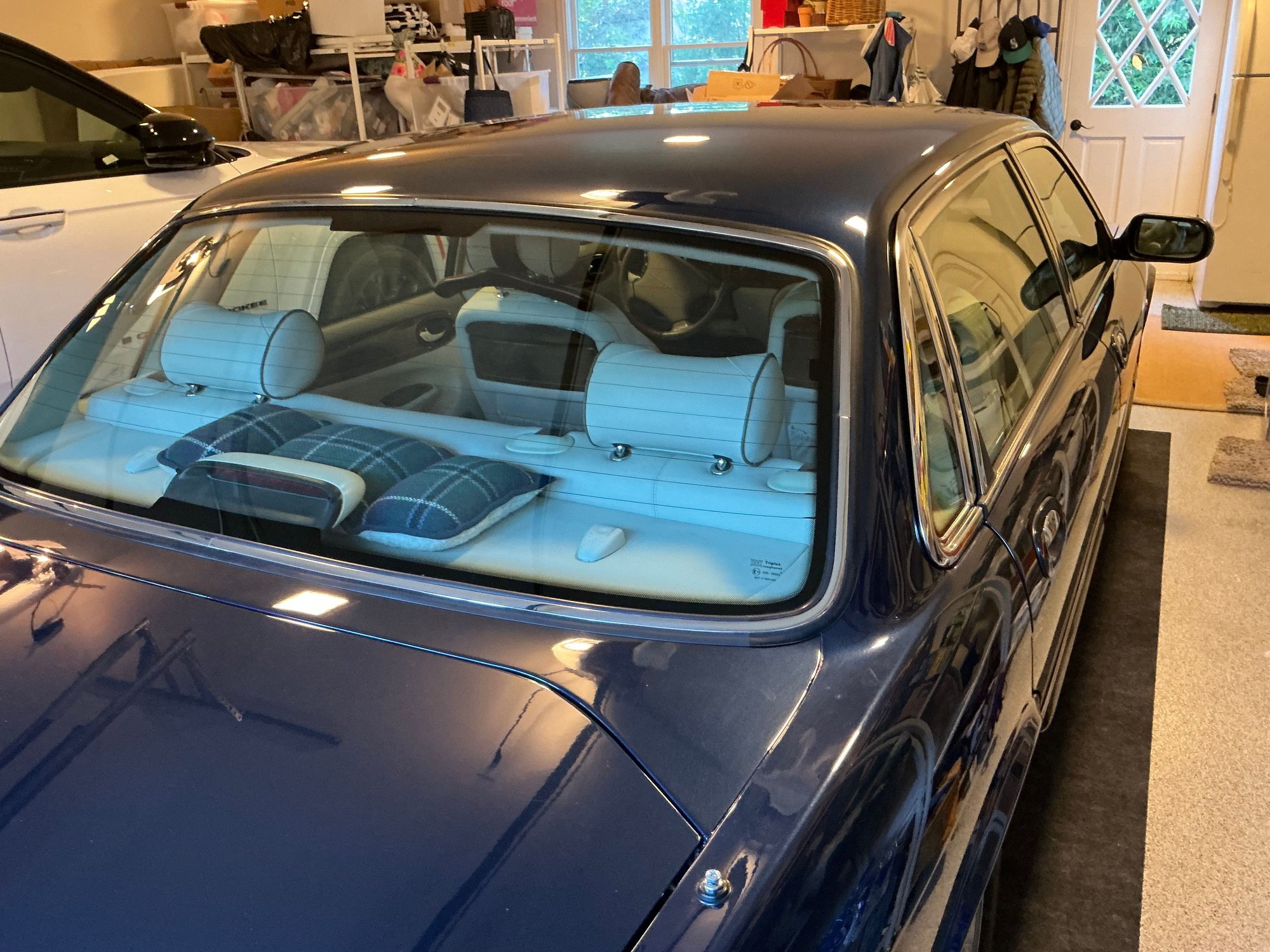

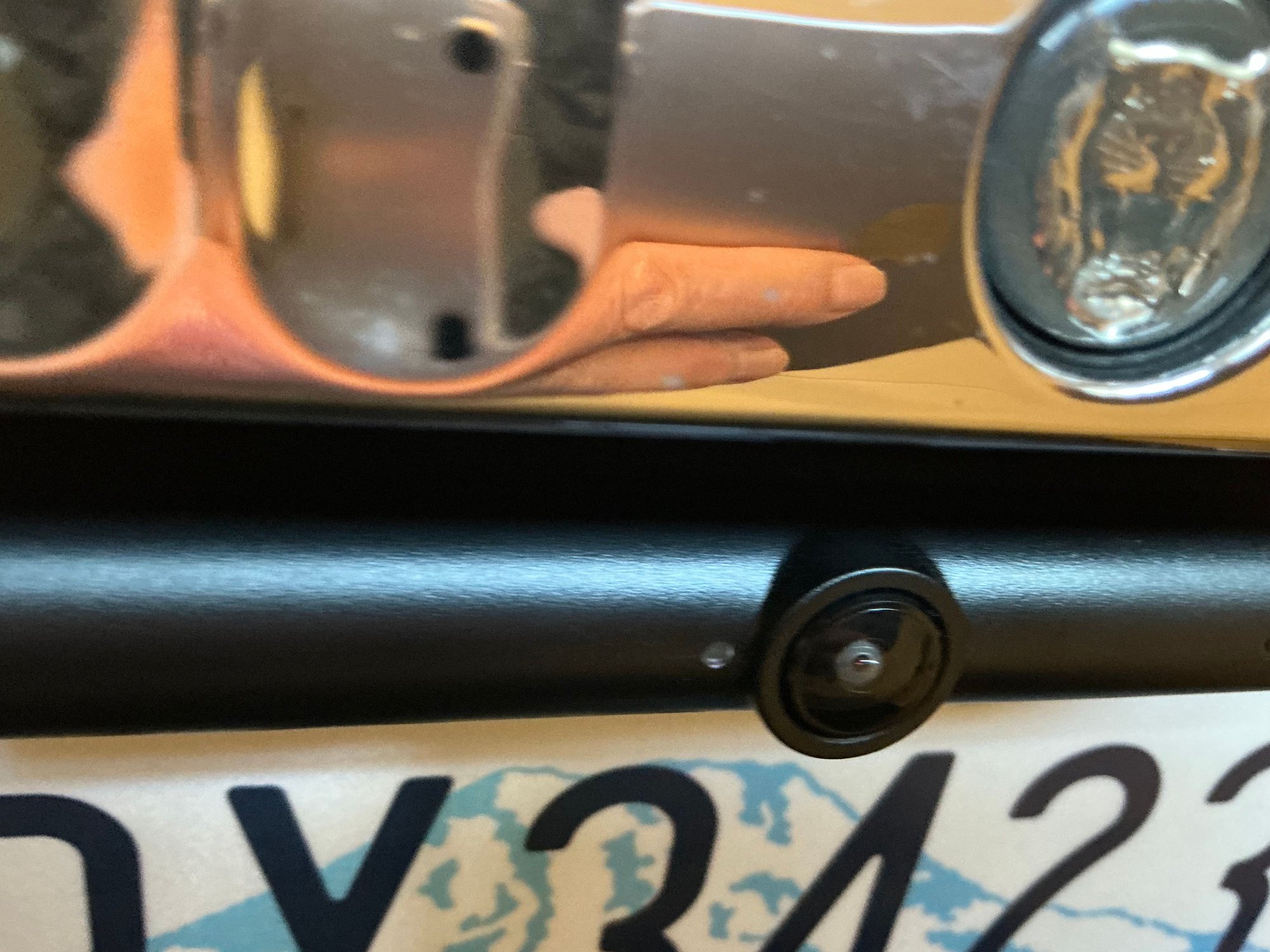

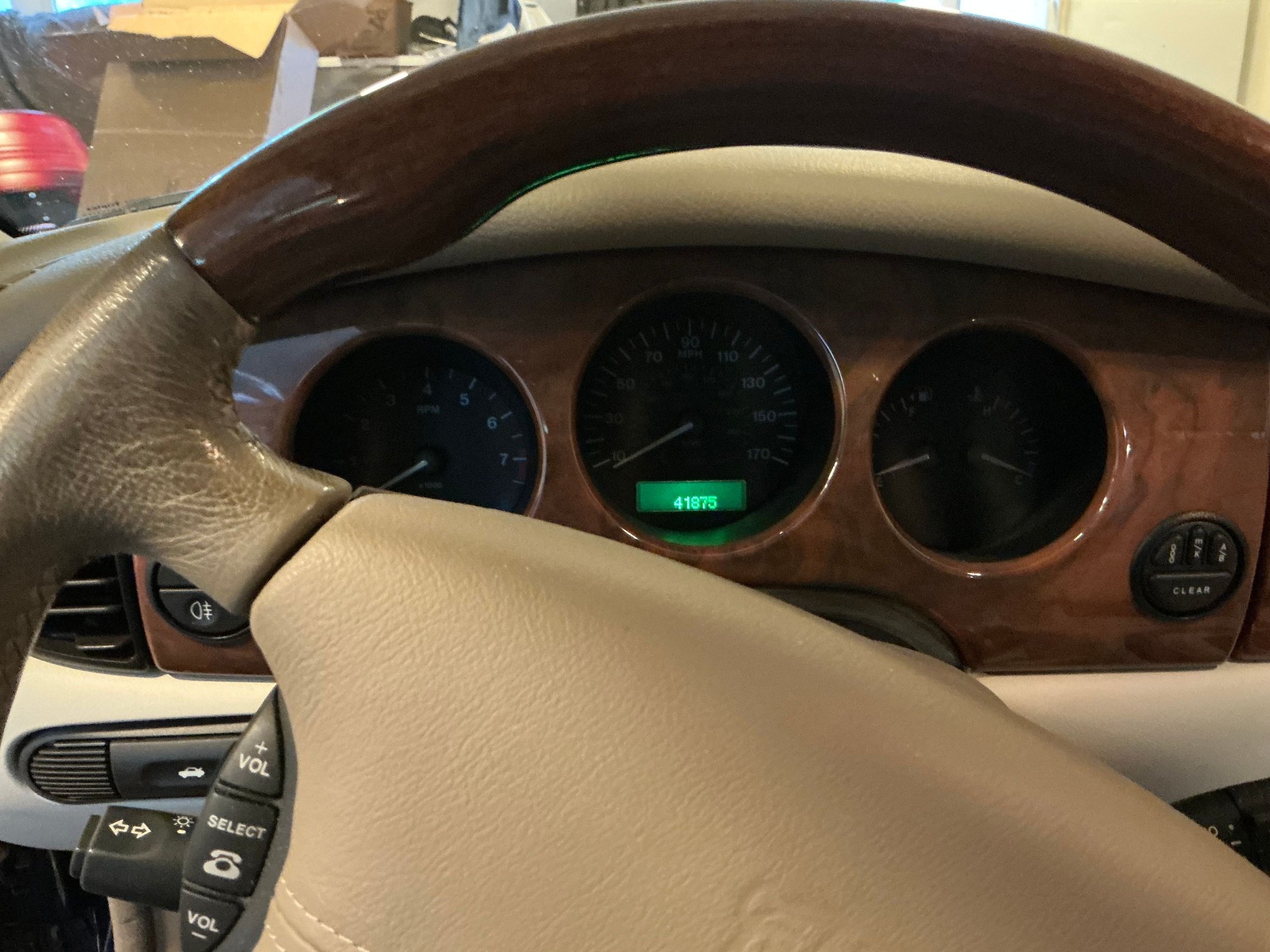

My VDP is like new. Got it from a friend who got it from his uncle. The car is near perfect. I have all of the records from new. Always kept inside. My friend added phone Bluetooth a Garman that I added rear camera.

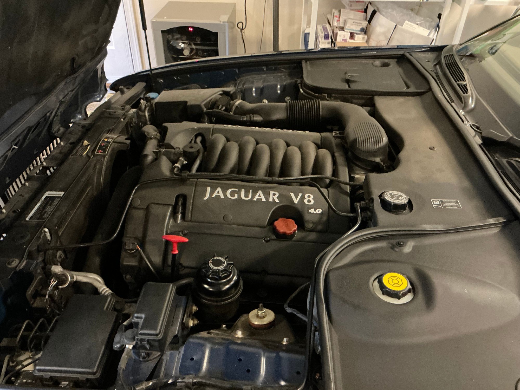

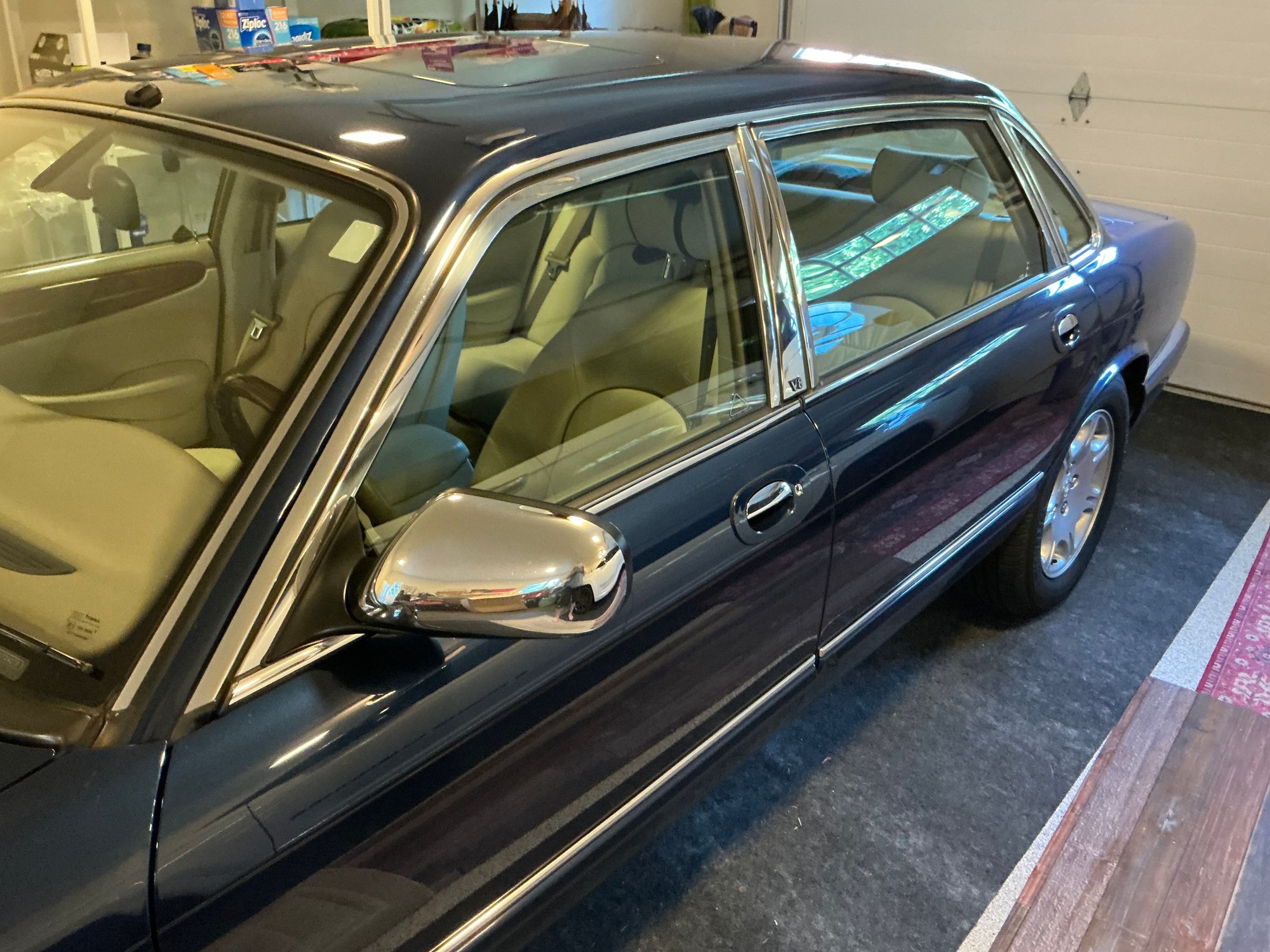

My question is too keep it nice, would you upgrade the transmission with Transgo, the fluid was changed at 28k. The water pump timing change, batteries headliner, Tires 3k on them now. It gets driven a little, I don’t like parking it in malls. I have a charger ready when parked for a week or more. Needless to say no rust, dents, a bonnet plastic was put on when new and I only found it when I found the records. What would you recommend to keep this car perfect

Paint is like new
Paint is like new

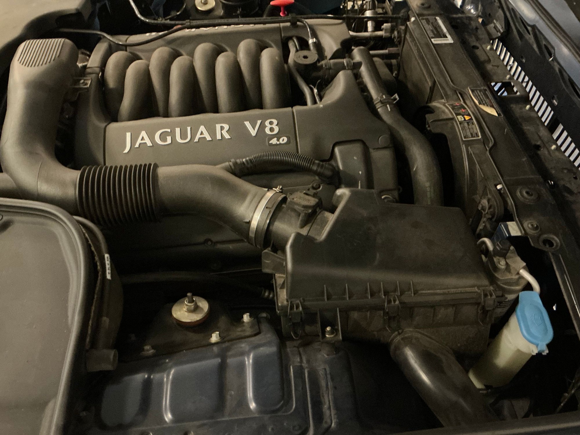

Clean engine
Clean engine

My car came with the Garmin nav. I added the backup cam because it fixes the rear backup issue with a very quiet sound. My friend wanted a car with modern systems, IPhone connected to the FM radio, Sirius radio installed in the sunglasses case.
