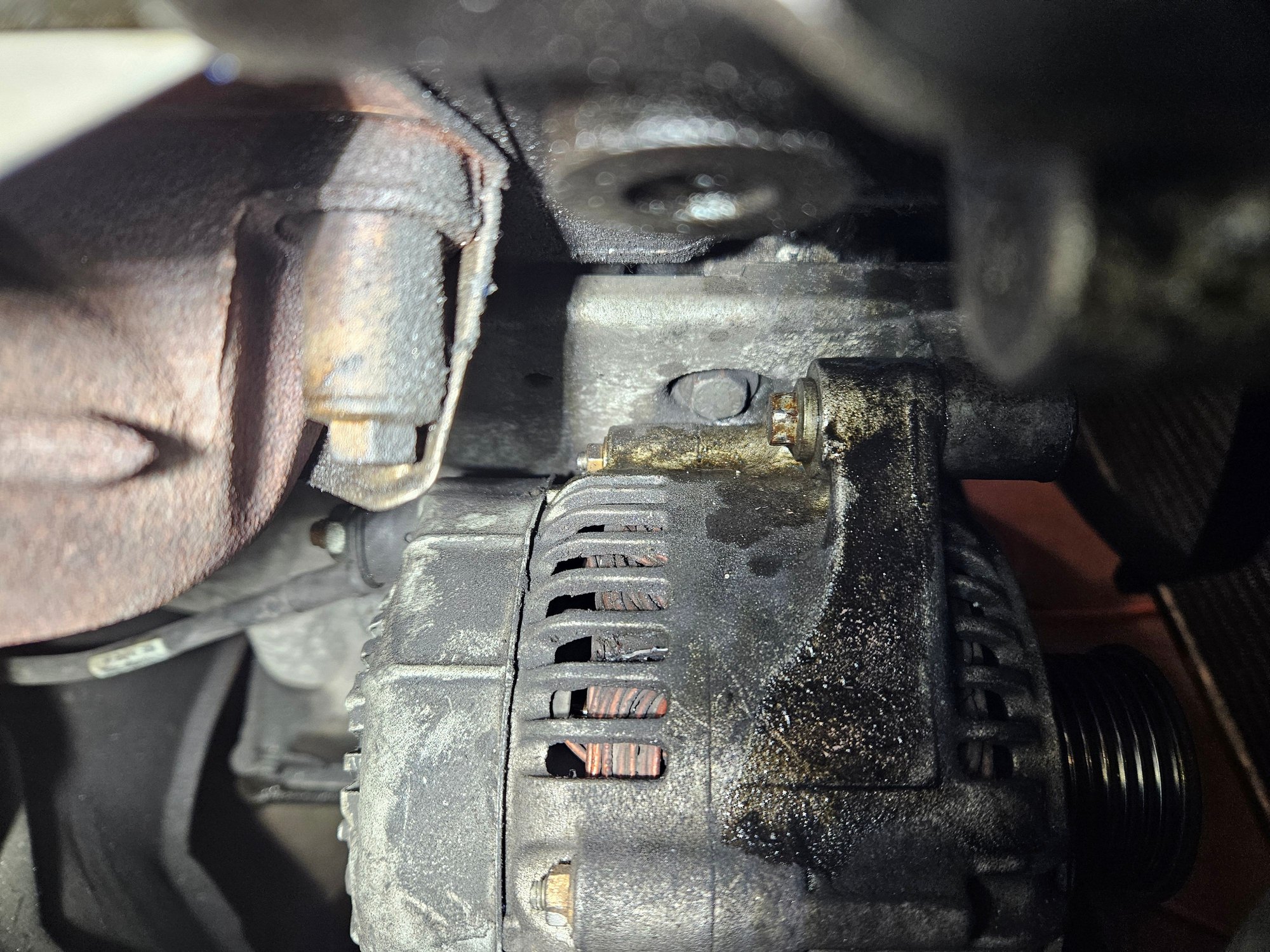

I can feel and hear the bearing in the alternator when i turn it by hand, so I'm (fingers crossed) fairly confident it needs to be rebuilt.
Problem is getting the darn thing out. Wire and plug came out fine, bottom nut and bolt, easy enough. But that top 10mm bolt seems to be frozen in place. I put a 6 point impact socket on it and applied steady pressure for a bit, its really not budging yet and i REALLY don't want to snap the head off it. I've fought with it for the last hour and decided to stop before i break it. Left it soaking in PB Blaster on both ends, maybe tomorrow will be better. I suppose if i snap the bolt, at least the alternator will then come out and i can remove the bracket and maybe get the rest of the bolt out or replace the whole bracket if necessary.
Is it possible to remove the whole alternator bracket with it still in there? Looks like two bolts are easy, third one maybe...is there a fourth behind the alternator?
Any useful tips here?

Can you pull (rotate) upwards on the bottom of the alternator to loosen the bolt?
You could also reinstall and tighten the bottom bolt. If you continue to loosen the top one without the bottom bolt, the loosening action could potentially set the alternator at an angle (albeit a very small one but, every little bit helps) and guarantee to shear the bolt. This is just what I’d do. Maybe spray some penetrating oil overnight?

Thanks Pete! The video describes my situation nicely, so I'll try the heatgun later when I get back to it. Locktite would explain everything.

Heatgun seemed to be the deciding factor. I ran it on high for a bit and preheated the housing for the threads and the bolt began backing out nicely once it got moving. It was a bit tricky getting the alternator itself out after it was detached, I can't imagine how some people can claim to have take it out through the wheel well as the alternator is almost twice the size of the opening through the suspension, but a few twists and turns and it came right out the front.
Located an actual rebuilder, dropped it off after work last night and he called me by 7pm and said it was done, so I ran back and picked it up. He said the rear bearing was a pain to get out and that some of the brushes had actually come loose. All fixed, pulley spins freely and silently now $81. Should be able to reassemble Friday evening. Looking forward to driving the car again, its been awhile, but on the other hand we've had on and off snow and other sloppy weather, so this forced storage kept a lot of salt off the sheetmetal.
