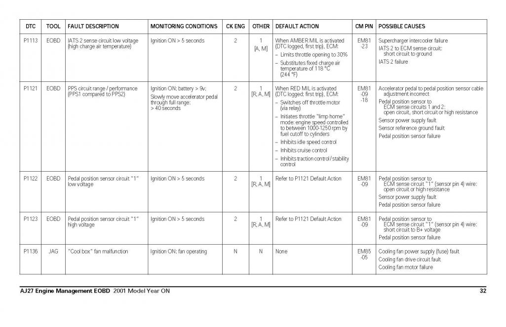

Below is DTC Summary Sheet that has P1121 & P1122 on it, I extracted it from the JTIS CD. Here is the jpeg file:
There seems to be more details in this DTC summary sheet. Lists 5 different possible causes are listed for P1121.
Hope it helps
