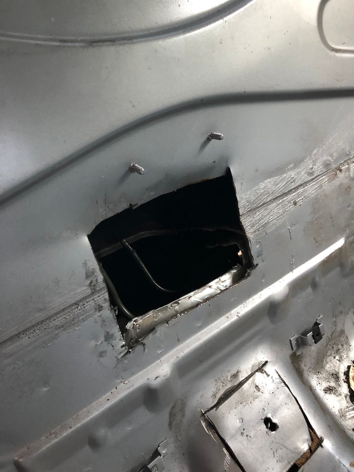

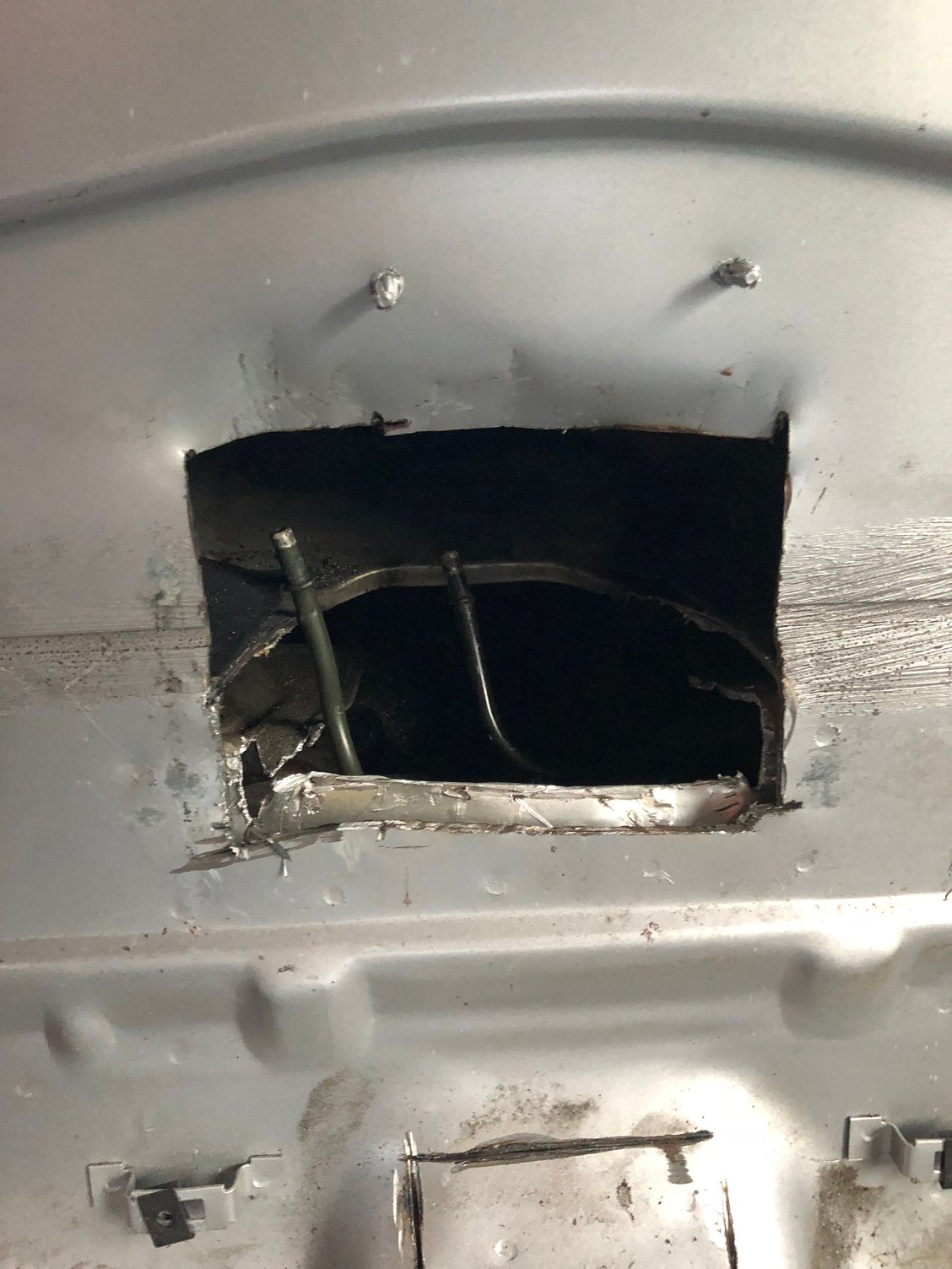

Old Jul 24, 2018 | 06:46 PM
Djmcmann's Avatar
Joined: Jul 2018
Posts: 65
From: Anderson, SC
Default Cutting through back seat yo access lines
The problem is solved in terms of accessing the disconnects for the gas lines for this fuel tank. Huge issue but now going forward it will not be an issue. See the attached pics.
In the end there was no problem with the gas lines and the connection. Rather the issue was the gas tank itself that was rusting out from the inside and had many pin holes on the bottom that require patching so I sent the tank out for reconditioning. As of this post I’m waiting for to come back

Old Oct 20, 2018 | 11:42 AM
PeteK812's Avatar
Joined: May 2014
Posts: 295
Likes: 52
From: Bloomington IN
Those holes in the back seat area look like they were made with a cutting disc in a grinder. Right? Wrong? Weren't there gobs-o-sparks? Seems like that would be a good way to die in an explosion.
Old Oct 26, 2018 | 09:09 AM
Djmcmann's Avatar
Joined: Jul 2018
Posts: 65
From: Anderson, SC
A few points, first of all, I ran the car until the gas tank was empty, even then, I started it multiple time and it would run a few minutes and stop. It was not until it would not start at all that I determined the tank was empty as much as I could get it. Second, I opened the trunk and doors and let the car air out and dry out for over 2 days before trying any cutting. In regards to the actual cutting, I did first use a grinding wheel but only to make about a 3 inch straight lind cut, from there, I changed to a sawsall with a small blade and cut the blance to reduce the chance of sparks. The entire process worked great with no issues.
