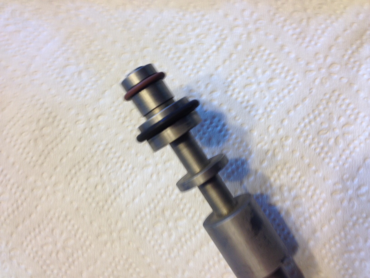

Default Scheduled for tomorrow...
I have a day off tomorrow (finally) and plan to conduct this transmission service. In preparation I cleaned the new valve with carb/choke cleaner, blew it dry with my air compressor and wiped it down with a paper towel. Then, I put just a little Assemblee Goo into the two grooves and slipped the gaskets in place. I put the sizing O-rings over them to hold them in place, put the valve back in the plastic bag it was shipped in, and put it in the freezer.
The gaskets separate so they can be "opened" and slipped over the valve. This made assembly easy but I worry that they won't stay in place after setting, since they can open up like that. Is that a baseless concern? Should I have used more Assemblee Goo (which dissolves away anyway, right?)?
I just want to be sure since, once installed, this valve will decidedly NOT be easily accessible again.

Old Jul 27, 2015 | 07:57 PM
harvest14's Avatar
Joined: Apr 2015
Posts: 1,386
Likes: 370
From: Virginia
Default Job completed...
The transmission service finally got done! I went very slow and actually enjoyed myself. The fluid that came out was dirty, but not as bad as I expected. Also, the bolts came loose very easily and the gasket was in great shape; pulled right off in one piece. The filter looked original however so I am conflicted as to whether this transmission has ever been opened since it was built.
The Transgo valve fit into the upper valve body perfectly. It's a bit heavier than the original valve and shaped different; plus it has the gaskets, which the original did not have. I called Transgo three times during the installation to ask questions. They answered on the first ring each time. The person who answered the phone was tech support and each time they patiently answered my questions. Refreshing customer support in this day and age. The installation really was very simple.
The car took ALL 6 liters of ZF Lifeguard 5 fluid I had and didn't overflow until it hit about 51 degrees Celsius. I drained all the empty 1 liter bottles and got about 100cc more, which I put in the transmission using a syringe. Basically it's full, but I didn't have a DROP left over. Made me a little nervous.
Date night with my daughter afterwards, so about 20 miles of test driving. It shifted smooth before this service; in that it paused very briefly and shifted without any problems. It still shifts smooth, except smoother. Sometimes I did not even know it shifted unless I watched the RPM gauge. The most noticeable improvement? When I was idling/coasting around parking lots before, the car would seem to need an unreasonable amount of RPM to engage the gear. It would rev and then "catch". I tried about a dozen times in a parking lot tonight after the service and it never did that. It would immediately move forward when I touched the gas. Very nice.
Yes, I'm long winded. I type fast so basically by the time I've thought about what I want to say it's already on the screen.
Anyway, I am very happy that I conducted this service and also very happy about discovering the Transgo valve.
