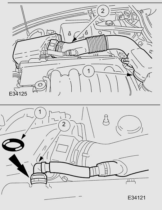

Check the breather pipe to the A-Bank camshaft cover and the O-ring seal on breather pipe.
Here are illustrations I copied and put in a JPEG file showing the Breather pipe fitted to the A-Bank camshaft cover and the O-ring seal:
