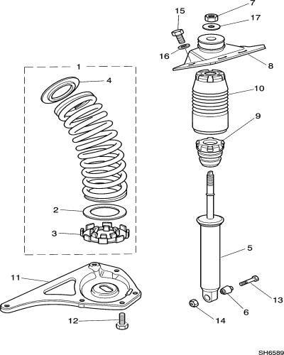

Hi all. Just wanted to confirm that it has struts in the front and shocks in the back...correct?
Thanks!

I have moved your post from the forum for the X350 to the forum for the X308, which is the Jaguar factory code for your 1998 XJ8L.
Regarding your suspension, the front is a shock absorber or "suspension damper," Part 5 in the diagram below, with a separate road spring that is mounted in a curved orientation that is common to many Jaguar saloons:
The rear suspension has a shock absorber that fits inside the road spring but is replaceable separately. You will either have Part 7 or 18 from the diagram below, depending on whether you have the adaptive damping suspension or not:
I grabbed these diagrams from jaguarclassicparts.com, the parts service of the Jaguar Daimler Heritage Trust, which is a great place to view parts diagrams and part numbers for your car. You can also download the Jaguar Electronic Parts Catalog (EPC) from this forum so you can view parts lists and diagrams on your computer. See the instructions in this thread:

The front shocks are very easy to change. 30 - 40 minutes per side tops. I recommend you replace the upper shock mount bushings at the same time. Rebuild kits are available from vendors on this forum so you don't have to buy the entire upper sock mount from the dealer. The lower shock bushing comes with the new shock

This is the entire upper shock mount (steel frame and rubber bushings together). You can buy just the rubber bushings, remove the old ones, and press them into the existing frame. This saves hundreds of dollars vs. buy the frame/bushings together from Jaguar.

The price for the front mounts sounds like entirely new upper plates (that will have new bushings in them). You only need the bushings and you re-use the plates. Do a search on this forum for " upper shock bushings kit".. There are also several detailed posts on how to install the new bushings into your existing plates
