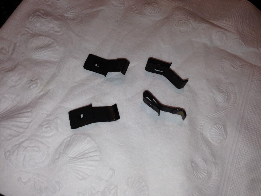

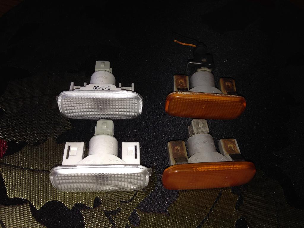

1. you have to file away some tabs from the white markers to make them fit, compare the clear and orange ones and you will see what you need to remove
orange markers needed for the metal clips and they also came with one plug so I could make the wiring harness needed for one side. clear markers to install on the car
removed the rusty clips from the orange lenses, wire brushed them, and spraypainted black to extend life and not add blatantly rusty stuff to my car

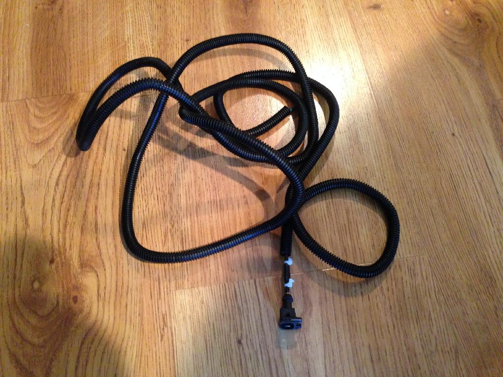

Harness ready for install

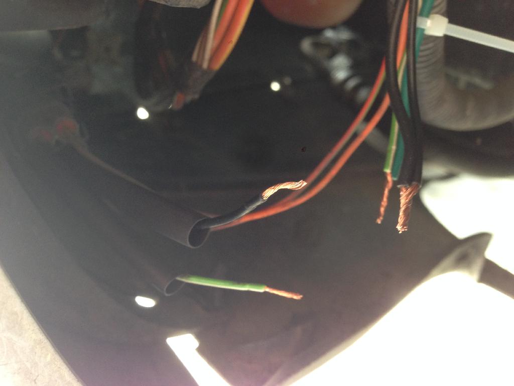

Location of the splice. On my car I needed to splice into the green wire with white stripe on it and the black wire from the 4 wires right by the side of the front bumper. Confirm this on your car before you cut, things may be different for different years.

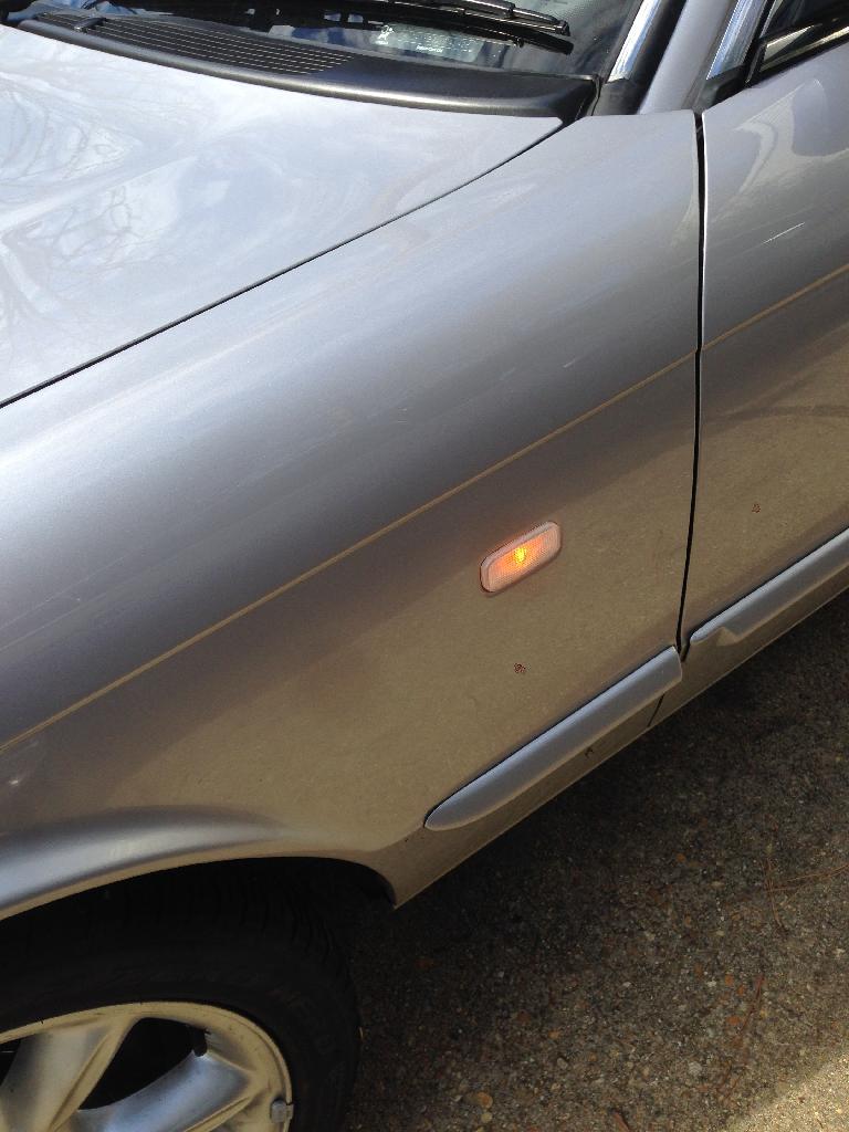

Done
Done

all 4 of mine included bulbs and bulb holders but none of the bulbs were orange so I still had to acquire orange bulbs for my application

I did this conversion recently, but since I am a stickler for originality, I stuck with the orange lenses. The right hand side of the car was indeed plug and play. On the left side, I removed the front wheel, and fender liner so I could run my harness from the new side marker along the inside top of the fender through the stock wiring clips that are there, then down to the front turn signal. I think the harness needed to be about 8-9' long as I recall. Also, I used IDCs to attach the new harness to the existing turn signal wires so no factory wiring or connectors were changed. All in all, this is an easy addition.
I am very happy with the results, and now feel like I have more of a fighting chance for a safe lane change on crowded S. California freeways.
