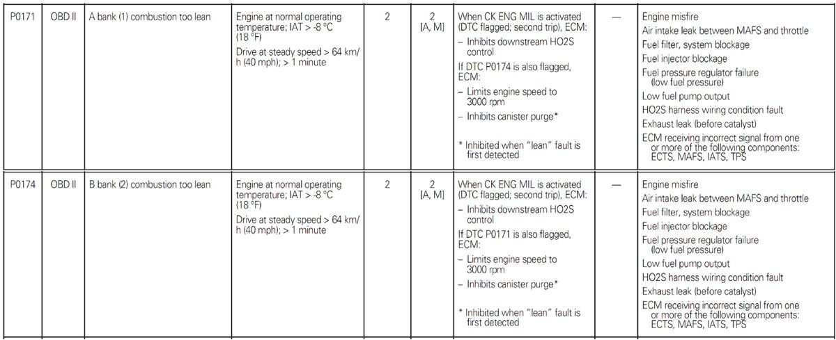

I presume you mean you got codes P0171 & P0174. If they show again, look at other things (other than vacuum leak) that can cause them:

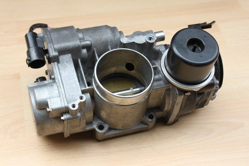

Just had a look at my new (spare) TB but it is for AJ26 engines and you have AJ27 which, I believe, has somewhat different TB. Anyhow, the throttle plate on my new TB sits practically fully closed but I can see a very small gap towards the bore, something like 0.5 mm. The identical TB currently running on my engine will open to something like 5-6 mm with the ignition "on".
I can also see on the new TB that there is an adjuster/stop screw for the "cold" (the 0.5 mm) position of the throttle plate. The screw is just below the bell crank (to which the cable attaches) and it is covered with white paint to preserve the factory setting. If you have more than the mentioned 0.5 mm gap between the throttle plate and the bore, the factory setting of the stop screw has either been altered or your throttle plate does not, for some reason, go all the way back to the screw-stop.
Does your TB look like this or is it different?

Hello! Thanks for chiming in :-) my TB doesn’t have that black kettle on top. I think yours is the earlier model... So there is a small gap? That’s interesting. Have anyone measured it using the OBD? Based on what I read so far it should be less than 2%. Mine is way more....
