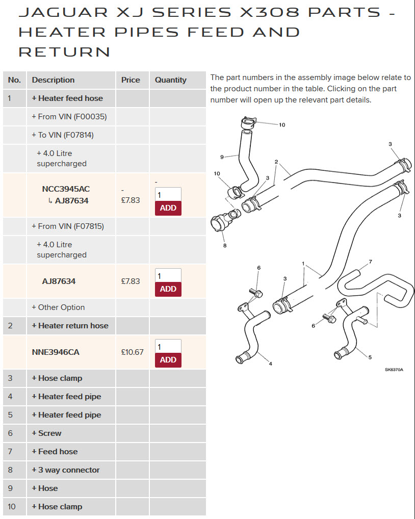

+1 on valley hoses (= heater return and feed lines) + connections (e.g. part 8 = the 3 way connector of the heater return line is prone to fail too, since it's made of plastic and sits right above the LH cat)
Second possibility are the small coolant hoses going of the throttle body and/or EGR valve.
Another possible source of the coolant: Octopus hose (see this thread here https://www.jaguarforums.com/forum/x...nt-hose-75681/).

Sticking to the heater hoses, you can see that there had been a revision of the heater feed hose from engine no. F07815 on (AJ87634). Thus the revised version has been replaced for the earlier engines too....
In case of the return hose it remained unchanged. It's the same for the connectors.
So best way to find out is to consult jaguarclassicparts.com in case you have any doubts about parts numbers.
