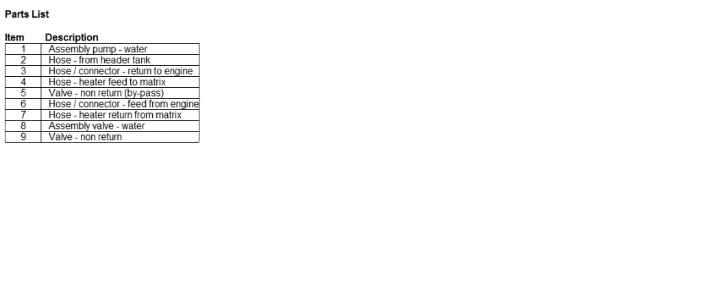

Here is the diagram and parts list from the JTIS21 Jaguar shop manual:
Here is the heater diagrams from the JEPC - Jaguar Electronic Parts Catalog:
Maybe there is some way to patch your existing hose instead of buying a new expensive one or maybe you should just spring for a new hose.
