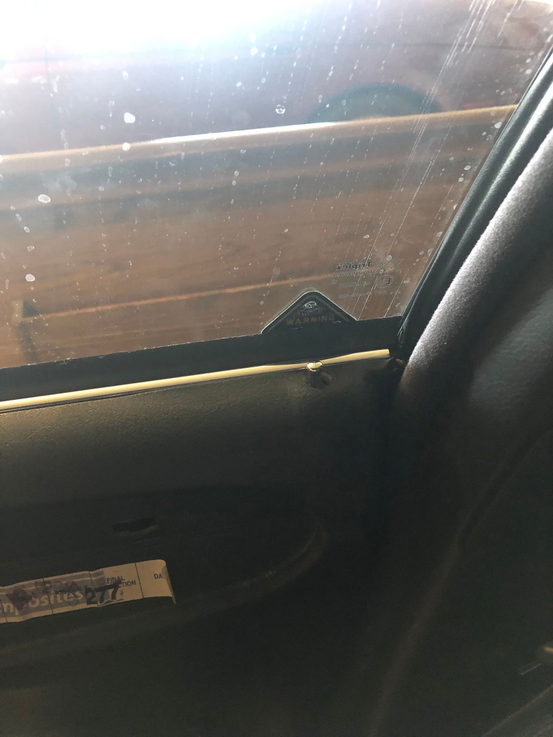

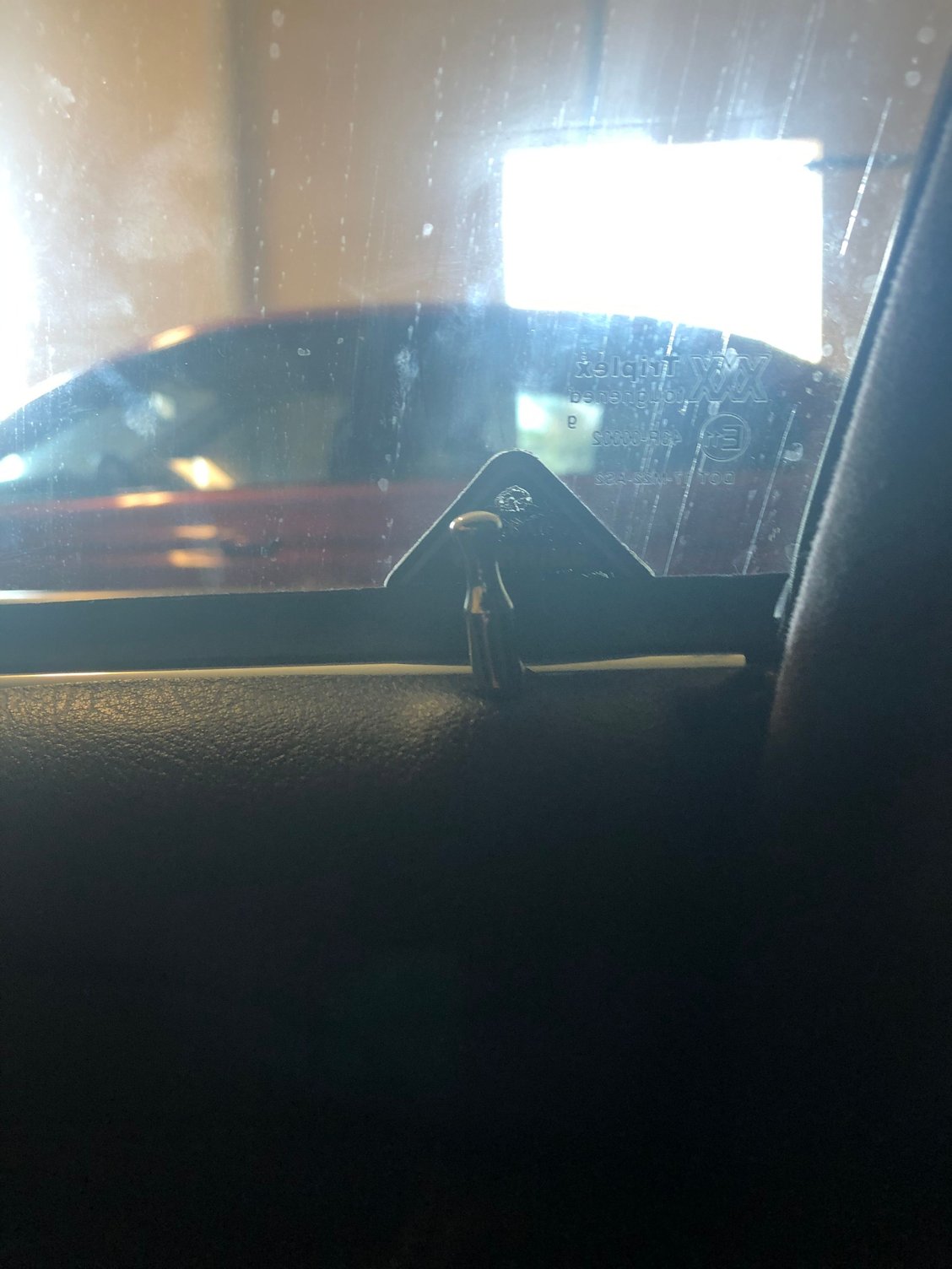

I found out what it was but I’m not sure how to fix it. It’s seems my passenger side door lock as come out of balance and is now bent when I have a friend move it into place the car will lock and the alarm won’t go off but when it is just resting on it’s own it will trigger the alarm

Take the door card off again -- carefully this time -- fix the latch and reinstall -- carefully, this time!
