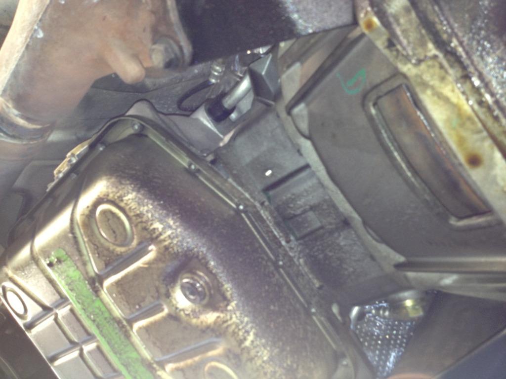

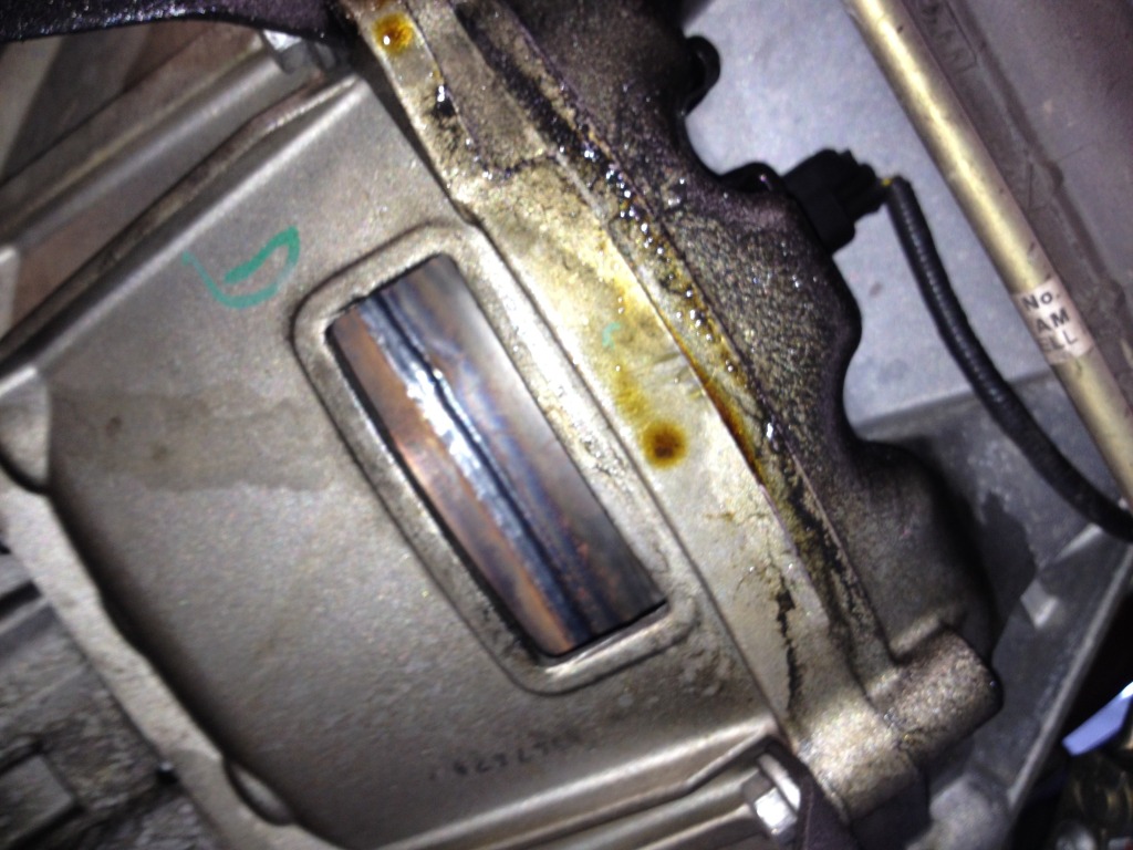

There seems to be a oil leak from the rear of the engine. I can't really see where it comes from but I would think it is some sort of fitting and not the rear seal as if it was leaking I would imagine they would have caught it when they did the transmission. I'll post a photo below.

It looks like a leak coming down the passenger side of the engine and my bet would be valve cover.

+1 to dsnyder586 on the oil leak being from the valve cover which is neither difficult nor costly to rectify.
