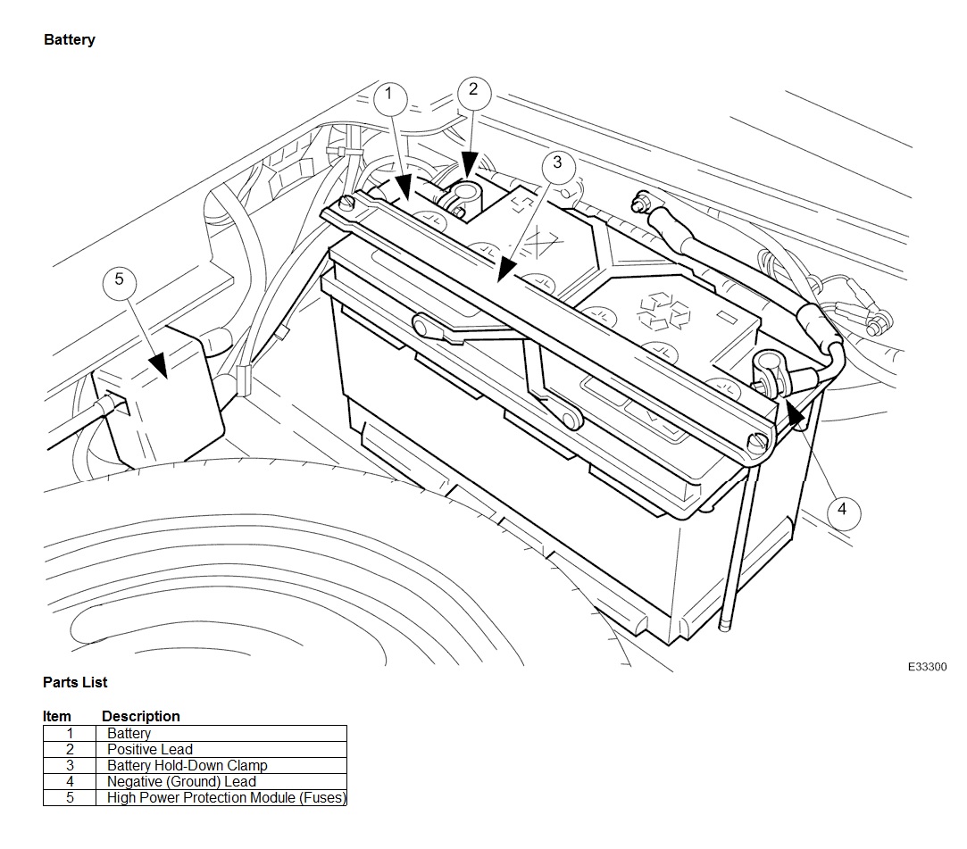

Before condemning the battery and eagerly looking for expensive solutions ( ), it's worth checking the positive cable (item 2) connection to the High Power Protection Module (item 5)
Although I can't recall reading of this in relation to the X308, loose or corroded terminals is a regular issue with both the XK8/XKR and X-Type. The X308 is a similar setup so it's a possibility.
