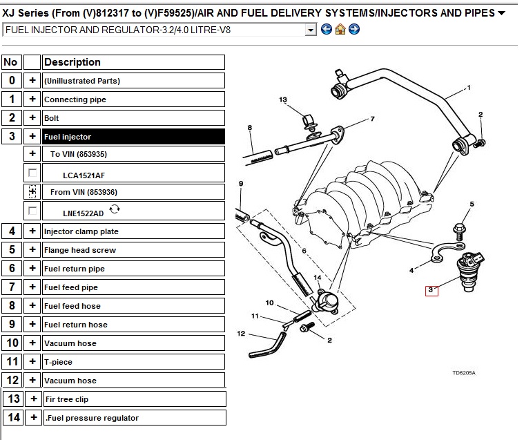

Ok so its the 3rd week after buying the car. I find that there is a petrol leak, called in the mechanic and he says that 3 injectors need replacing as the previous owner or mechanic has tampered with it and damaged them even though only one is leaking 2 others are damaged as well so replacing them will be ideal.

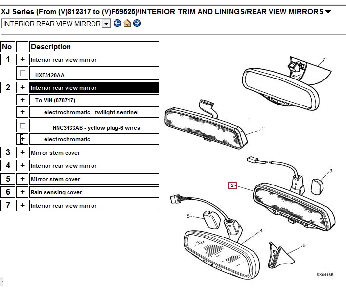

Also i know my car came with the auto dimming rear view mirror which needs replacing as it just loosely hangs and the only thing i can see are the passengers at the back. Now i think my car comes with the Auto headlight option since i can see the auto mark on the light shaft which doesnt function when i turn it on and im not sure about the rain sensing wipers option either.

1) Could you guys help me with the part number for injectors, cost of new or used and where i can source it in england
2) Part number of the rear view mirror

Here is the Injector Part Numbers for the 3.2 Litre:
Here are the Rear View Mirror options:
If you have Rain Sensing Wipers fitted, there will be an AUTO position on the rotary collar. Set the rotary collar to AUTO and the stalk to INTERMITTENT wipe to use the function.

I believe the Auto Wiper also has a sensor built into the Rear View Mirror in the mounting bracket.

Ebay has everything. Use Ebay UK to save on shipping. The mirror should just need an
adjustment. Mine used to fall off, but I got it to stay without replacing it.

i got in touch with a breaker company over the weekend they asked me if the injectors were bolt on on clip on types i was thinking once the part number is given it should be easy but never knew there can be more than one variant with the same part number..Lear45 thanks i get it shipped to a UK address and get some one to hand carry it over...the mirror is loose where the mount ball attaches it self to mirror bracket
