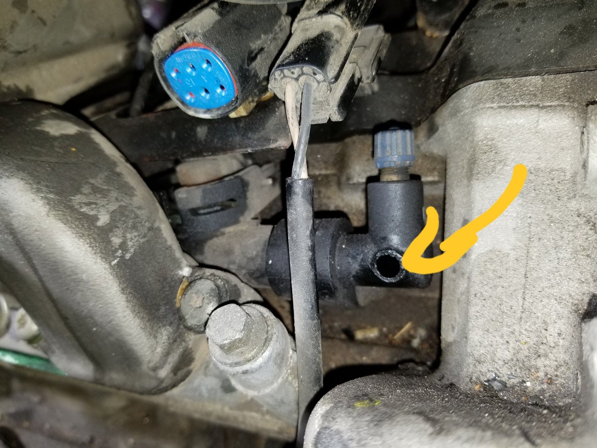

Any advice is appreciated. I broke this piece off this part while removing the supercharger. Does anyone have a part number for this or even a proper name for the part? I haven't been able to look it up or find the part. Thanks in advance for your help.

I had to wait until I got home from a little holiday and ironically I have my SC off also...I'm doing my knock sensors. Anyways, once I got back, I was able to track down where you spoke of and did a number of searches using many key words. I finally hit on a word combo (jaguar 4.0L fuel rail bridge hose) that brought me to what I believe is at least a lead to your answer. Purge Valve Fuel Line...but the issue is finding the one you need, here's a link to an '02-08 X-Type which is very similar... https://www.partrequest.com/auto-par...-113054906449# ...perhaps that will give you a lead?
Here's a shot using that same search, the Valve looks the same, just for a different application. Problem is it was an old ebay listing and came up as an error.

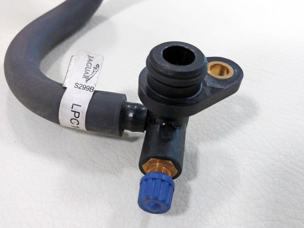

Thanks guys! I really appreciate both of your inputs as you both steered me in the right direction since I was completely in the dark and had no clue as to what the part was called. Just in case anyone ever runs into the same problem, the part number for supercharged engines is NCC3027AB and the description is simply "Fuel pipe hose". The part number that Diam mentioned, NCA3027AF, is for NA engines, as he stated. It seems there are not very many of these parts floating around. I called 13 different dealerships between Phoenix Arizona, Las Vegas Nevada, and a few different places in Southern California and none had it in stock, so they would've had to have ordered it and they all wanted between $190 and $215. Terry's jag has it in limited stock for $137. I ended up finding a seller on ebay who had them for $50 + an additional $9 for expedited shipping, so just under $60 the part and it will be here by Monday!
Being that the part is difficult to find, that tells me that not many people make the same mistake as I did, lol! Either way, I'll include pictures of the part since the hose and connections to both sides are all one part.
