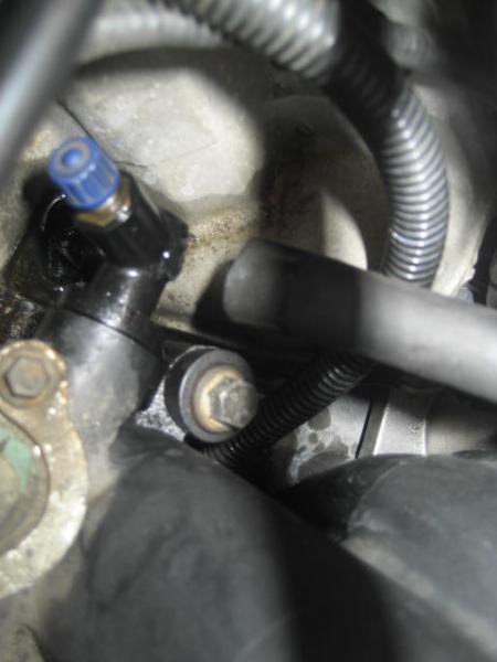

How difficult is it and what would I specifficaly need to remove in order to repair this leak? IE do I have to remove and replace the entire fuel rail or can I purchase and replace only the piece shown in the pictures? Hope that makes sense. This is from a '98 model XJ8 that I recently purchased. Thanks in advance for any thoughts, advice, or suggestions.

Oopps, looks like someone pulled up on that and broke it. Ask me how i know
you need a new intake. Those are not servicable and molded into the intake
