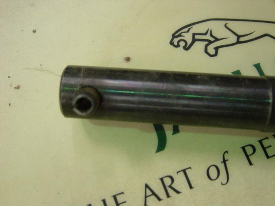

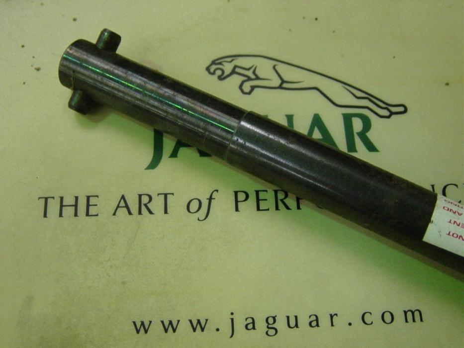

Here is a pic of the Jaguar tool top mount area. The roll pin goes through a 19mm stepped down area of the 20mm rod. The Jaguar tool is 20mm X 2.5 but the 3/4" all thread is 19mm so it can be used. The all thread rod IS soft steel but the long nuts that can be purchased and LOTS of antiseize compound will allow the rod to be used several (or more) times before the threads become worn and start to gall.
If all you want to do is lock the spring in place and hold it while you remove the lower control arms, then the few threads you use to compress the spring slightly will be more than adequate.
I would remove the arms one-at-a-time so the lower plate does not lose the location and float around too much.
If the spring needs to be removed, then the proper tool or the long bolts would be a good idea.
bob gauff
