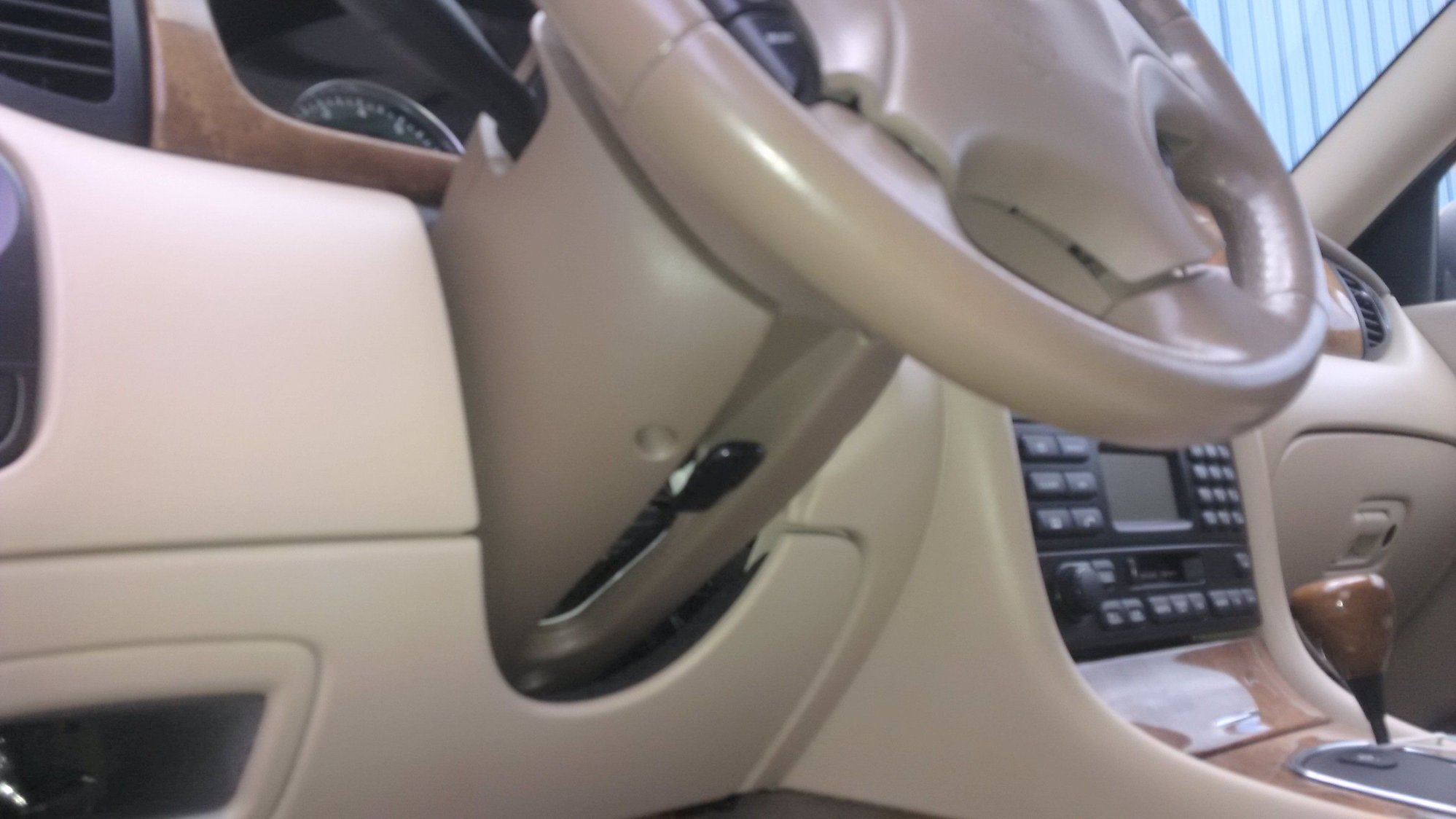

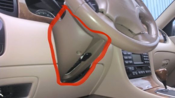

Was anyone able to pin point the problem here? I am in Canada and last winter we had -40c and I froze driving this 2002 Jag X-type. I need this fixed but would like to give the mechanics an idea what to look for.

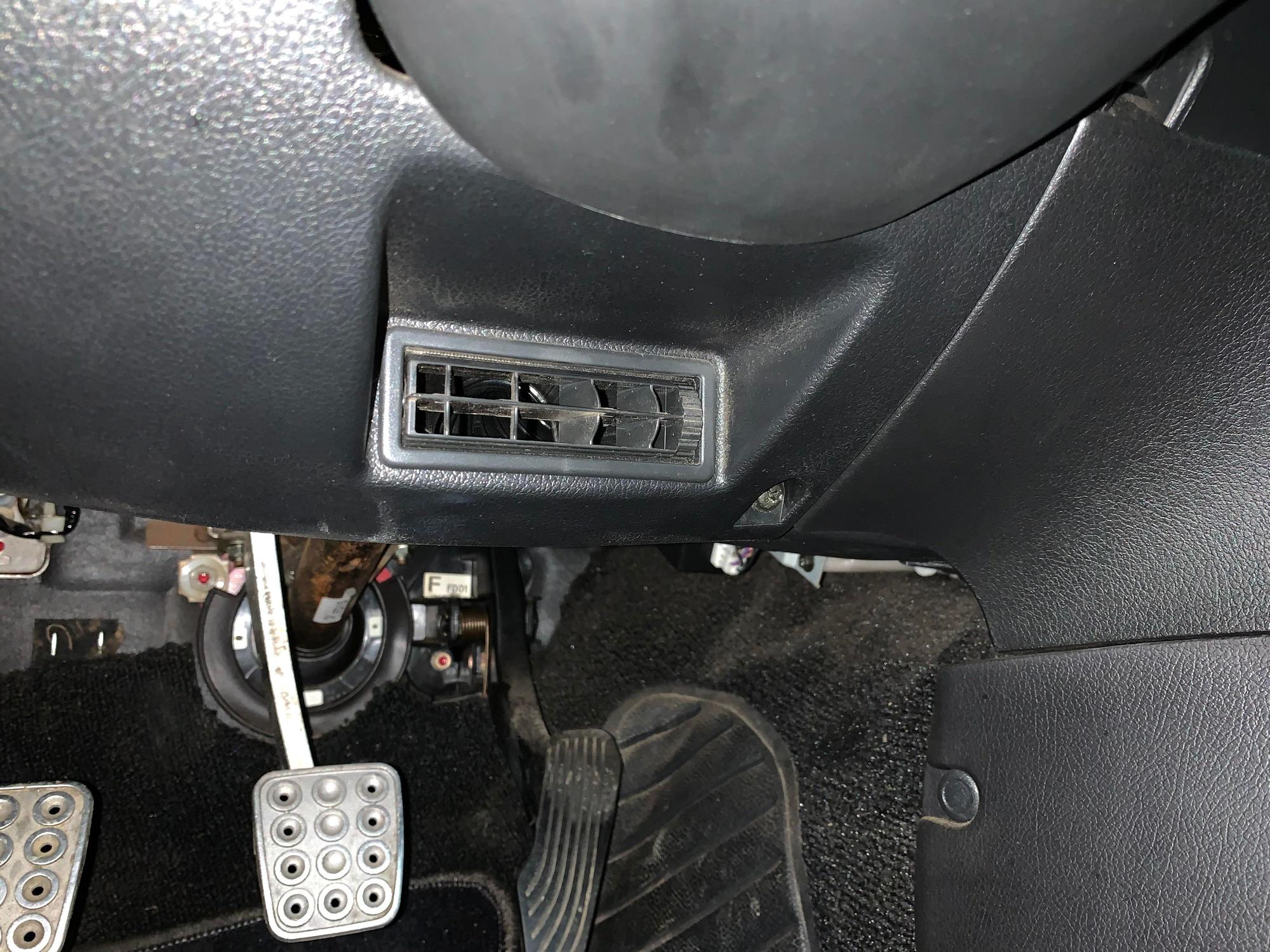

i think it’s a crack in the knee panel ducting that does this
see if recirc stops it

Old Aug 21, 2021 | 05:01 PM

It's not coming from there. It's a gap in the steering wheel column, on the bottom on it, that has cold air blowing out of it.

It's coming out of the space where the lever is to adjust the steering wheel. It blows quite hard and is very cold when the temperature is -40.

Anyways, what I would do is remove the lower steering column cover. If it’s blowing that hard, you should be able to pinpoint where the air is blowing from more accurately while driving.
