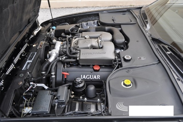

Hi all,
I'm brand new around here, and followed rules by posting in the intro section first! I had an XJ6 years ago; it was wrecked though, and haven't had one since. I've been in the market for bit now and think I've found "the one".
I found a local ad for a 2000 XJ VDP, supercharged, black on black, 46k miles, $14k price. I thought maybe the supercharged statement was a misprint.
So, I went and looked at it. It's legit. It's also in near-mint condition, with almost zero wear on the inside. It could sit on a showroom floor. I think I found one ding in the chrome, and that's after looking hard.
I drove it, and it's incredible. Acceleration is smooth, as is the ride. Great feel all-around.
So then... through reading this forum, I've made myself aware of some potential issues, such as the Nikasil problems and the tensioner issues. This car has been fully serviced at the local Jag dealer for its entire life, but I don't believe these 2 areas were addressed. I'm not too worried about the tensioners though, as I would probably just do that as preventative anyway if they've not been replaced.
I know they're incredibly rare. I'm just wondering if anyone knows of any other known issues I should look at. Maybe I'm being **** about it... but buying a 13-year-old performance sedan is a bit nerve-wracking (I've had BAD luck with 2 German autos so am gun-shy).
Any thoughts or feedback would be most appreciated.

You should be worried about the tensioners and you need to price that swap out into the price. Do those immediately or you run the risk of the engine going kaput and spending 5k or so to replace the engine. I'd worry less about the nikasil as long as you use 93 octane fuel. But even that, i'd have some money set aside to replace.
The x308's are pretty solid aside those two issues you were concerned with, and really easy to fix issues yourself which cuts down operation cost. Other than that.. a 46k mile car is a stellar find and I doubt the normal wear and tear issues exist.

You did hit on the weak spot,T/Chain tensioners, and with out a doubt you have the old type, but as you don't have VVT, not a big deal Mine did'nt make noise untill 115k.
Fuel pumps are a soft area and this can be an age and or miles issue.
Rear headliner will sag, If it already has not, there are many fix's on this site.
You have the 772.6 trans(this is good) all In all this cat Is bullit proof If just fairly maintened.
