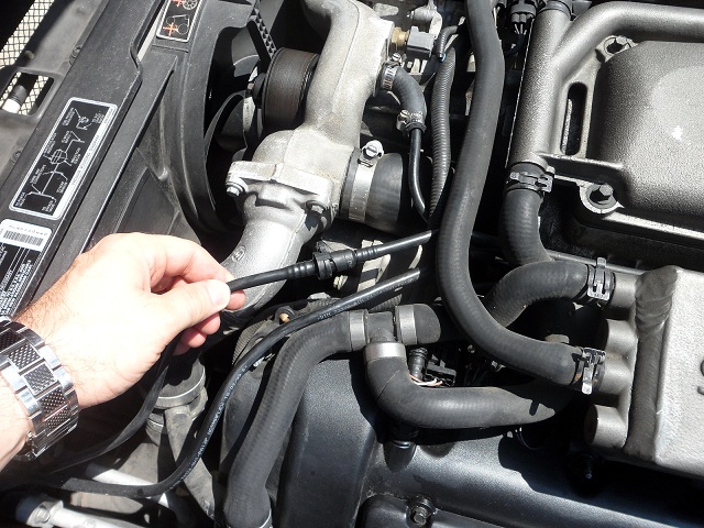

It's leaking coolant and I can't seem to find the parts # for it.

Are you speaking of the connector on the small hose?
I believe you need to buy the whole hose -- not expensive.
Check the other ones carefully -- they get brittel and moving them around while servicing can cause damage

I was looking at replacing the whole hose. I just can't seem to find the parts # for it.

I think your answer may be in this thread
https://www.jaguarforums.com/forum/j...numbers-53004/
I had the one from my expansion tank to the coolant crossover bridge connection break a few months ago, these tubes are extremely weak and it's a pain to remove the connectors

Hi
I found this information on these Coolant Expansion Tank Hoses in the Jaguar Electronic Parts Catalog (JEPC). Here is a JPEC file I created:
Coolant leak found, but can't figure out what part this is-xjrcoolant-expansion-tank-bleeder-hoses.jpg
I am not sure if the hose you need is #7 or #6 in the diagram. But I think it is #7.
Jim lombardi
