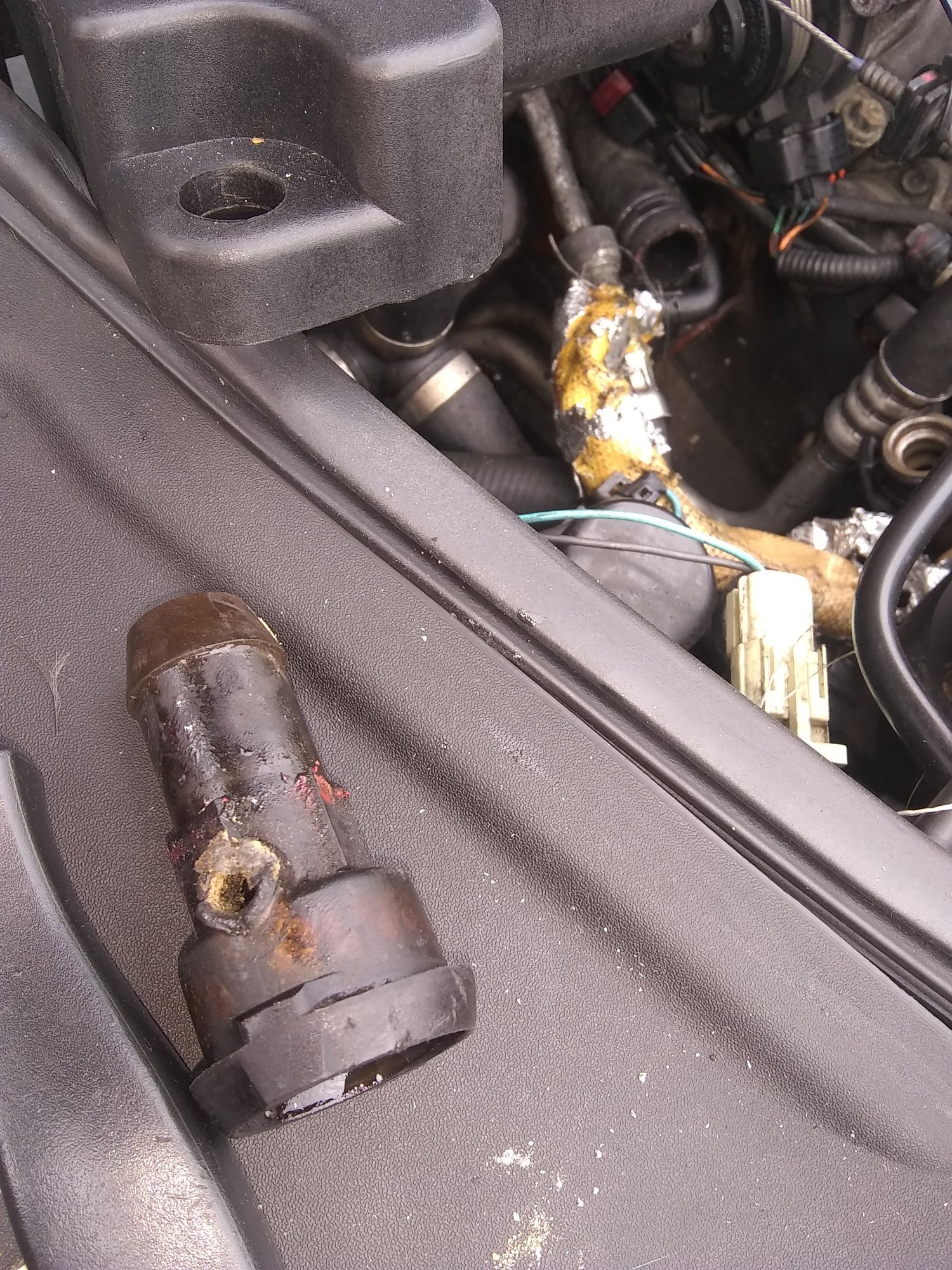

Today another drive on the highway with speed up to 250km/h (up to the limiter). In front of my garage sweet smell of coolant, quick check: the new coolant tank is OK, but the hoses under the tank next to the throttle body look a little wet. A little bit of touching/feeling here and there and the little hose of the three way connector broke off. Not very easy to reach, but doable. Partnumber is NNE3944BA, hope that my Jaguar dealer only about 5kilometers away will have the part ready to install again. Price should be about 10 Dollar (8 Euros). Lucky, that it broke off at home...
