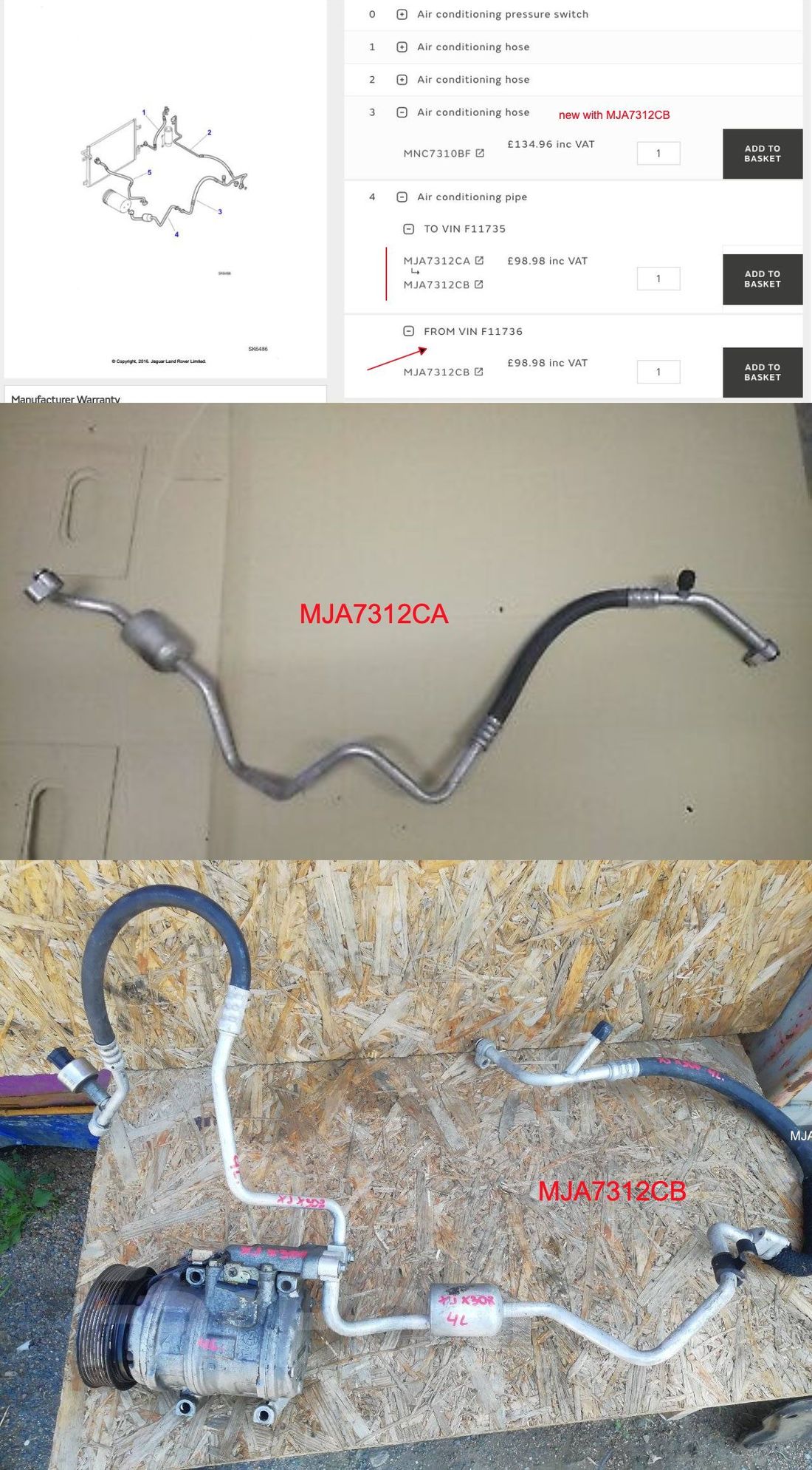

Old Jun 22, 2020 | 01:11 AM
bforsik's Avatar
Joined: Jan 2011
Posts: 63
Likes: 10
From: Kobenhavn
Don, you are absolutely right. Without his TSB submission would maybe never come to this source of the noise.
I did some research and I think the picture of the parts catalog belongs to VINs after F11735 within MY00. My VIN is lower. MNC7310BF is newly introduced with the 2-piece version.
I also attached two pictures of both pipe versions.

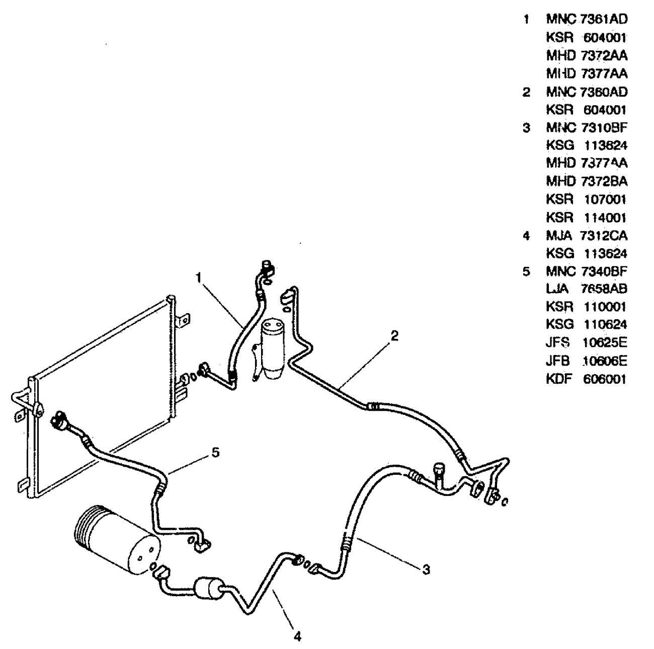

Old Jun 22, 2020 | 01:55 AM
M. Stojanovic's Avatar
Joined: May 2017
Posts: 1,699
Likes: 897
I have seen quite a few confusing cases in the parts catalogue. The page I posted earlier shows the old p/n MJA7312CA but the diagram shows the new shorter pipe MJA7312CB which must be used together with MNC7310BF. If you search the Barratt website for the old (long) MJA7312CA, it shows that it has been superseded by MJA7312CB which is incorrect - it has been superseded by MJA7312CB+MNC7310BF (the website does not tell you that).
Another thing in the parts catalogue one has to be careful about is when, for the engine parts, it shows two different p/n, early and later, for the same (function) part with a change-over at VIN 853935. This applies only to NA engines and not to SC engines. In such cases, for SC engines, the change-over point was actually VIN 878717 (change AJ26 to AJ27) but the catalogue does not tell you that. Initially, following the parts catalogue, I bought a few wrong parts for my SC engine.
