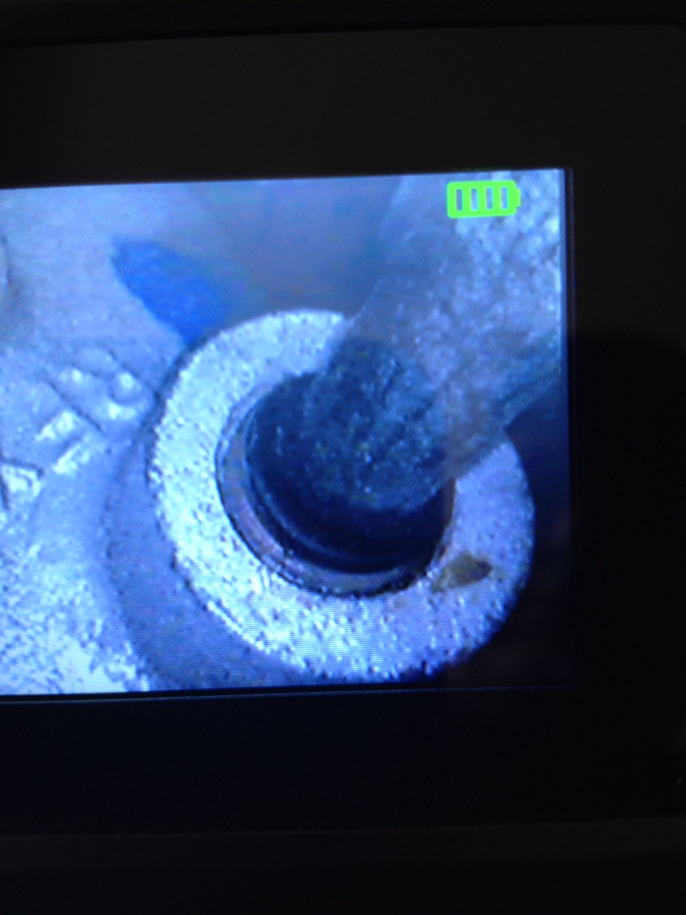

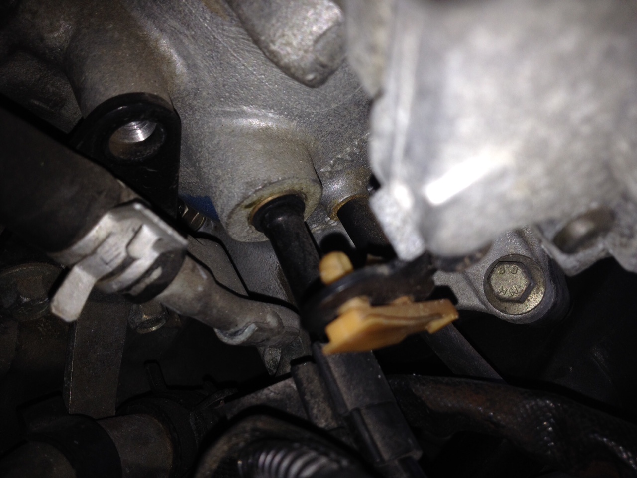

I hooked up the new smoke test machine today and found a leak in what I believe is the throttle body elbow at a vacuum connection. I am thinking this is the air assist connection? I really don't know. I'm in research mode now. If anyone can review the attached pictures and advise me that would be greatly appreciated. Mainly I want to know HOW to fix the leak.
One picture is of the auto inspection camera (boroscope?) screen and the other picture shows the leaking connection point pretty much at the center of the frame.

I will have a look at this myself in the coming days, but was just wondering if the leaking is obvious (after you located it with the smoke tester), or if you really need the tester to confirm it.

The leak was not obvious, even after I knew where to look. The amount of smoke coming out was fairly significant, but there was no other indication of a leak.
Since the parts to repair it won't be here until next week I coated the area with a layer of RTV and retested. No smoke came out after the temporary RTV repair. When I test drove it though, there was only a minor improvement in the fuel trims and while it seemed less, the rasping was still present. Perhaps the temp repair is not that effective or perhaps there are still other issues.
