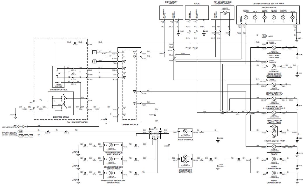

Are any interior headlight switch controlled / dimmable lights coming on? (door/window switches, gear shift... etc.)?

No, he asked about DIMMABLE controlled illumination, not steady state lighting.

Dimmer module or power supply to the module?????
QuadManiac posted the electrical guide page.
